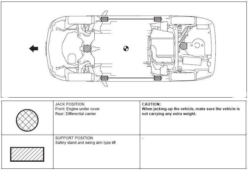

    Hello all,
    I've scoured the internet and have not been able to find an answer. I can not for the life of me find the rear jack point for the 2015 Prius C. I've looked at the manual but can't tell what that protrusion is. Is it the thing that I've circled in white?
    Any help would be greatly appreciated!

  12. Mendel Leisk
    61,477
    42,301
    Sure looks like it. Page 366 of the manual:

    Lancaster Co PA
    Yes that is the one I have been using on my 2014 C

    Do you think you or anyone else could post a picture of the front jack point? I really appreciate your pic and others verifying so. Trying to complete the 105k maintenance on my own with the tire rotations left.

    I have the manual and have seen the illustration; though I’d be much better for me to see a actual photo.

    The components in the line drawing look quite unique. It's near the front, central, I would just take a look.

    I want to jack my car up to do the Transmission fluid change. However the issue I have with the rear jack point, is that it's off center.
    This cleary seems that it would be an issue, in trying to evenly raise the rear of the car.
    Has anyone here actually used it.
