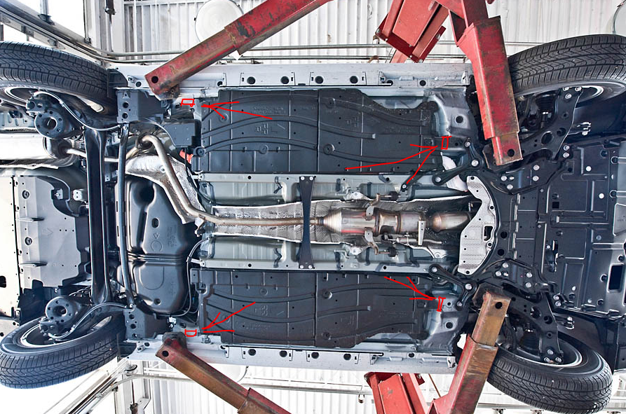

    A bit confused here, I know the pinch welds to jack up the car (I'm doing the front two tires) but where do I put the jack stands?
    If possible please reply with a graphic or image, thanks in advance!

    This is gen 3, but I believe gen 2 is VERY similar. The front points I actually borrowed from priuschat member Hobbit (IIRC). This is what I use all the time for jackstand placement:
    The front points are at the leading edge of longitudinal "rails", just beyond the zone covered by plastic (on gen 3). The rear points I turn the cradles 90 degree, they're on these reinforced, heavy-gauge "humps", that have the oblong slots (used for locking pins when shipping?).
    Twice yearly for the last 15 years ownership I've had the whole car up on these points, for swap between all-season and snow tires. Also at least 30 times lifting the front only, for oil changes and the like.
    I put a floor jack at either the front or rear central jacking point, and whichever end I'm raising, I place heavy, rubber wheel chocks fore and aft of each wheel at the other end. Typically raise the front first, and release rear parking brake (after chocking wheels), so car can "hinge" at rear axle.

    Depends on how much clearance you need under the car... If not much clearance is needed I've found putting jack stands where the front wheels control arms bolt to the frame to be one of the easier spots that's higher up. And if I need to get the car way high up in the air with multiple stages of jacking it up then I usually use jack stands on the outer part of the control arms close to the wheels.
