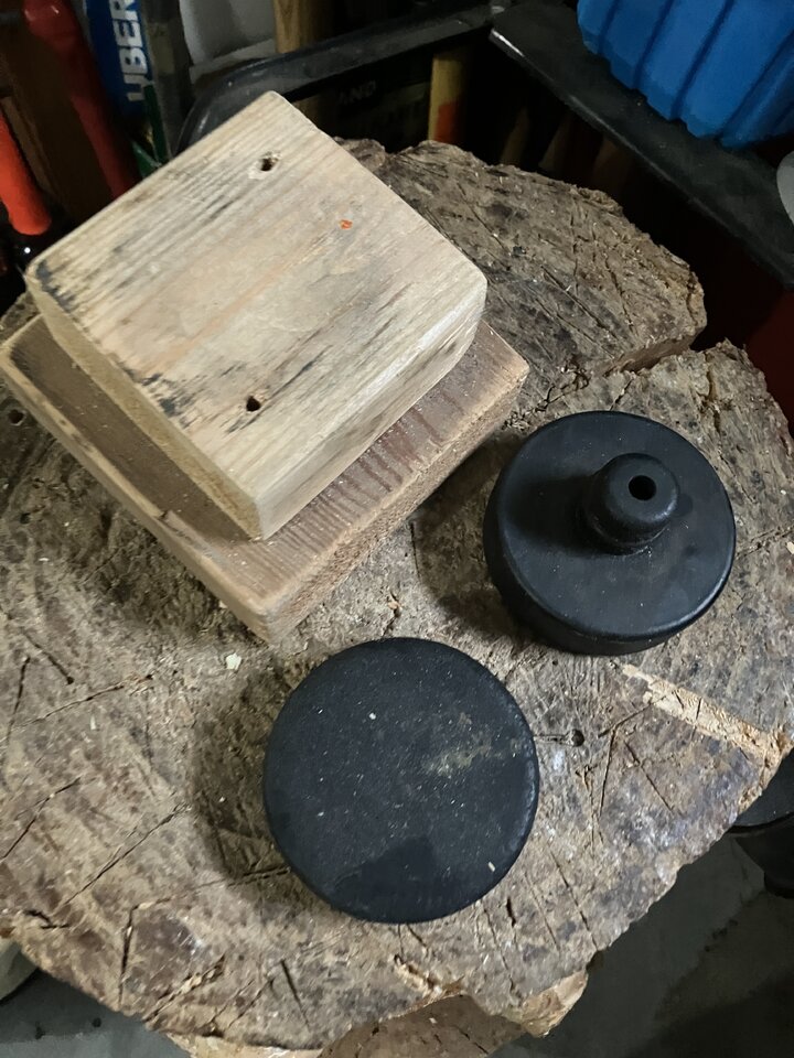

    I just put a hockey puck in the cradle of my old 3.5 ton floor jack, pushed it under the front tire change jack point, and pumped away.

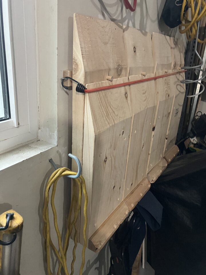

    There is a front jacking point, but I understand for gen 5 is pretty far back, about aligned with the front wheels. If you roll the front wheels up on low-rise ramps (say 3", a couple of layers of 2x...) it helps, both to get the jack under and to give enough clearance for the lever to get it started.
