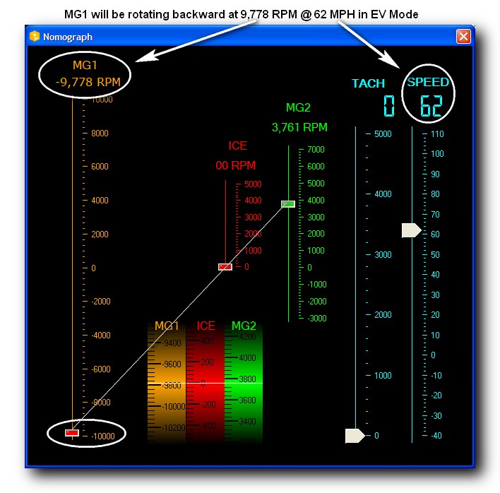

    This Plug-in HV weights about 100 lbs more. It does look like it is a Prius with additional HV pack. The peak power is 134 hp instead of the current 110 hp. This confirms my prior conjecture that the Prius PHEV will be faster!
    62 MPH EV mode is possible without any change in PSD because MG1 will be spinning at 9,548 RPM which is below 10k RPM that MG1 is capable of. This might be just a software upgrade to remove the limitation.

    My bet is the plug-in Prius has an external electric oil pump to lubricate the PSD instead of the ICE revolution.
    The parallel structure gets twice of kW power.
    It looks Prius needs only 15 kW to maintain 60 mph speed.

    The current PSD gearing will allow 100 km/h or 62 MPH quite nicely. MG1 has a 10,000 RPM limit as can seen in this Nomograph screenshot:
    You are correct though about some sort of reworking of the PSD as there is a very small chance that Toyota would run the transaxle at those RPMs without some sort of lubrication modification such as an electric oil pump that comes on during this higher speed, longer distances EV runs as splash lubrication is probably not sufficient & pressurized lubrication is currently provided by the ICE which is, of course, not running during EV mode.
