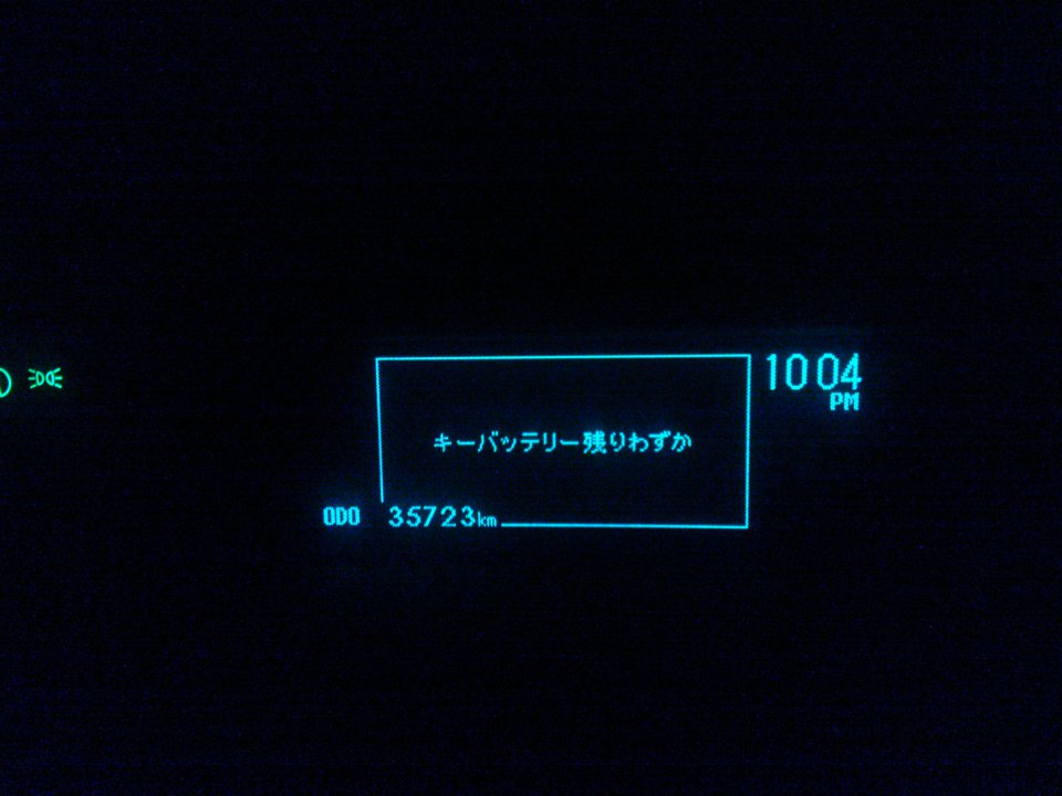

    I have prius 3rd gen 2010 japanese, used it without any issues for over a year. abt 3 days ago i got an error msg on the dash with exclamation mark when i stopped the car. since then it comes once in a while only when i stop the car. the msg is in japanese. pls help me, i dont know if its a critical issue. pls see image for the msg.

    It means your key battery is low and needs to be replaced.
    SCH-I535
    Don't believe me? :D
    Go to Google translate English to Japanese and translate: replace key battery
    Most of the characters are the same. ;)

  3. maffer
    maffer Junior Member
    Oct 10, 2013
    Thats it ??
    you are an angel!!!

  6. bigboco
    bigboco Junior Member
    Dec 11, 2012
    It tells you only very little power left on your key battery. Base on my own experience, the key battery will die in about a week after this message pop up. You should check how to start the car without key battery in case you won't be able to replace it on time.

    As you've made a significant investment in this car, you may want to protect your peace of mind by replacing both the keyfob battery (easily obtainable) as well as the 12v battery which is situated in the boot on the right hand side. The Prius isn't a fan of being jump started (don't get it wrong or it'll be expensive) and the 12v is a weird size, but it isn't that expensive to replace. Once you've changed both batteries you should have a reliable and fuel efficient car.

    This was very helpful.I had the same issue.It went away after i changed the battery of the key.
