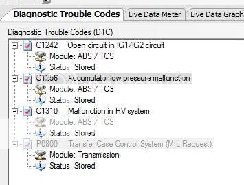

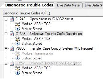

    update:
    I installed a new Exide battery (measured 12.9V out of the box), cleared the dtc errors and these kept coming back immediately after clearing.
    Then after a long drive I checked and these kept coming back immediately after clearing.
    Any ideas? I'm not finding anything when I google the unknown codes in the second scan.
