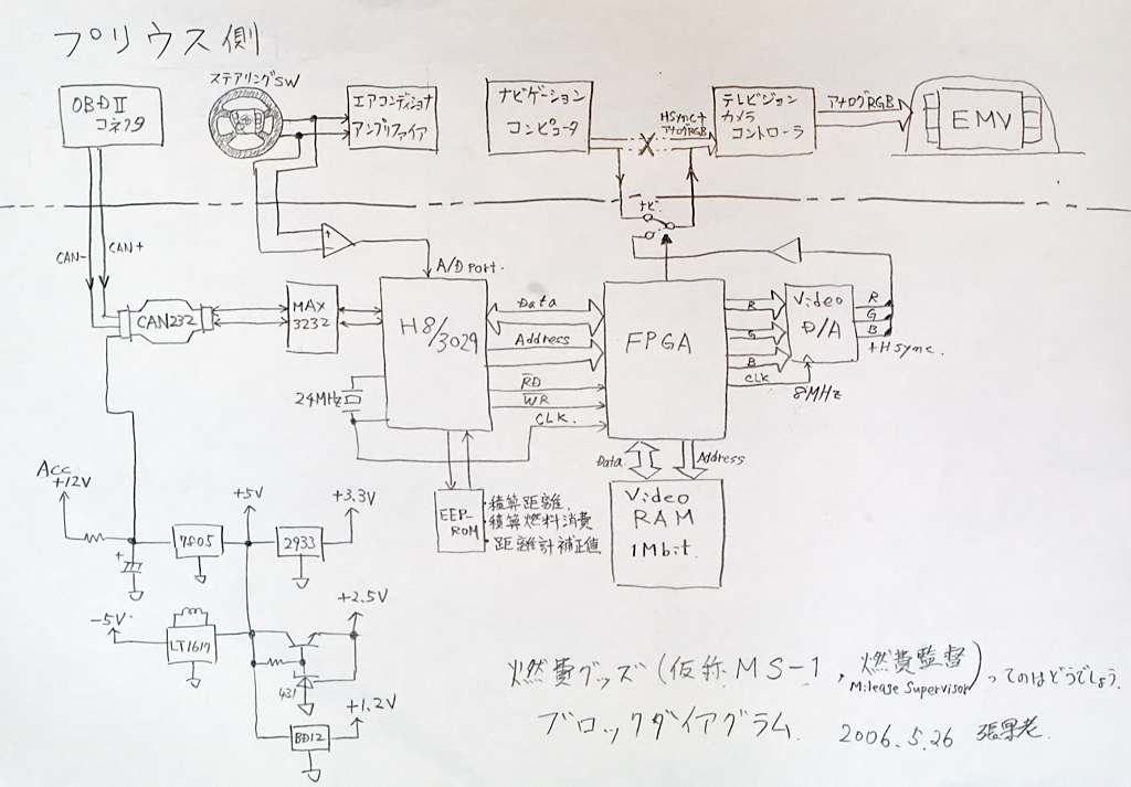

    I posted this info in the Found Reader (http://priuschat.com/Found-Reader-t20057.html) thread too:
    Wow, NICE display. I'm a CAN-View V3 owner and while I love my CAN-View, that display is awesome. Unfortunately I don't understand/read Japanese. but I did find the original post which is at:
    http://eshy.s22.xrea.com/cgi-bin/c-board/c...5746;id=epv1710
    Most of the Japanese to English URL translators are bad or don't work at all but I found that one that is pretty good. Try:
    http://www.excite.co.jp/world/english/web/
    and enter the URL above. Then you'll be able to get a "broken English" translation of each post in the thread.
    For instance the main post translates to:
    Making of fuel cost goods for trial purposes[/]b
    Hahatarou
    06/5/25 (Thursday) 7:29
    White Mr. EPV2 and nice to meet you.
    It is a person named Hahatarou that became a Prius owner in December the year before last.
    We wish always to express our gratitude for valuable information obtained here.
    It was stimulated by Mr. GTP of Mr. going, Mr. Attila, and Yami, and I also made the fuel cost goods.
    It is a thing and a display update speed that stuck to at which it is made to display in EMV. It was thought that it returned it even a little to getting the dissemination from you always, and made it contribute though the bug remained still a little (The temperature of the engine was a half).
    In the thread he also posted a circuit diagram!
    From reading the text I gather he uses the MAP steering wheel button to toggle between his system and the Nav system. Definitely RGB video output so definitely 2004-2005 MFD (EMV in Japanese)
