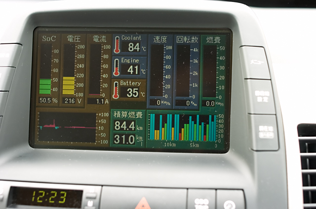

    Hi all,
    He now shows it on his site...
    http://khb00465.atnifty.com/
    http://khb00465.atnifty.com/ms-1.html
    (It's only in Japanese.)
    It now has his own CAN decoder instead of the expensive CAN232 device.
    We are discussing to improve visibility while driving, bigger fonts/simple display for easy to read.
    The screen resolution is the same among 2004-2005 Prius worldwide, however the current design is for Japanese model with Navi only.
    As of today, we have no information for Japanese non-Navi or for other countries.
    Kanji font to English font conversion is easy, but km/L to MPG conversion will need some work, I bekieve.
    Ken@Japan

    Hi all again,
    Please note that it is still a prototype. There is only one unit available for his Prius.
    He is now building the second unit for Japanese Prius with Navi for a monitor tester.
    Again, "As of today, we have no information for Japanese non-Navi or for other countries", which means he can't build one unless he found or someone supplied all electric signals and connectors information for the vehicle.
    Therefore, there is no plan to supply the MS-1 for any US Prius on any model years.
    Are there any volunteers who can send the US prius 2004-2005 and/or 2006 to Japan? :)

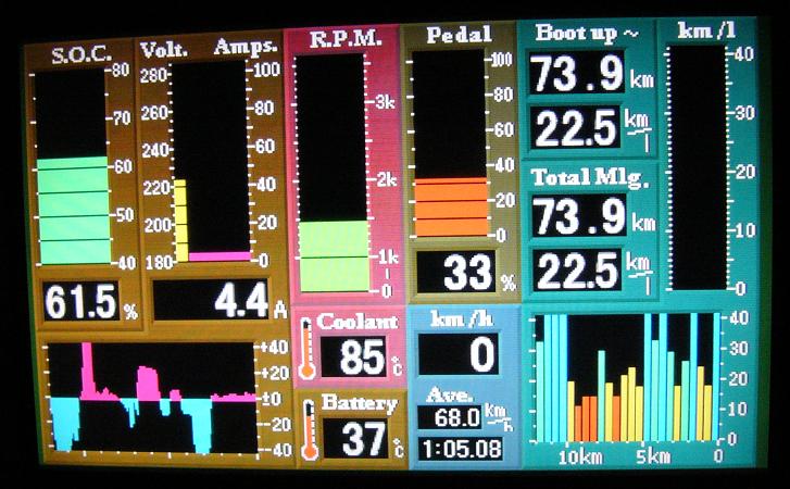

  13. ken1784
    ken1784 SuperMID designer
    Dec 18, 2003
    2,943
    1,384
    67
    Yokohama, JAPAN

    <div class='quotetop'>QUOTE(ken1784 @ Nov 6 2006, 08:27 AM) [snapback]344429[/snapback]</div>
    It is a very NICE LOOKING screen, I wandering what "eflier" would said? ;)

    <div class='quotetop'>QUOTE(ken1784 @ Nov 6 2006, 06:27 AM) [snapback]344429[/snapback]</div>
    New breakthrough!
    "2006 Prius MFD GVIF Video Input" thread
    Maybe, maybe? Eh, eh?
