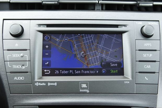

    Hi.
    I've got a JBL green edge car stereo system fitted in my plug in.
    What's the best way to get a stereo RCA output for a bigger power amp to run some much bigger speakers and a sub in the back?
    That's if it can be done?
