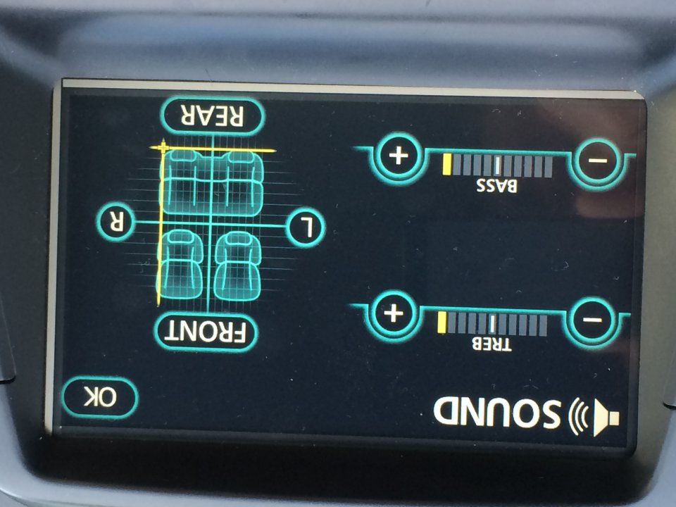

    The MFD works and I can change modes and stations, but no volume with the audio. Nothing for bluetooth handsfree, am/fm/aux/cd, etc.
    When I touch the sound button, I see the following:
    photo (2).JPG (it isn't upside down in my car!).
    I cannot change the treble, bass, or recenter the audio using the front/back/L/R buttons. Any suggestions?

    I pressed both up/down volume buttons on the steering wheel, and nothing happened. When I press the up or down volume button, I do not see anything on the MFD. The mode and up/down tuning buttons do work on the MFD. When I place a call from the MFD, I can change the volume on the MFD and with the buttons on the steering wheel; however, there is no sound. Is there a way the test the amp?
