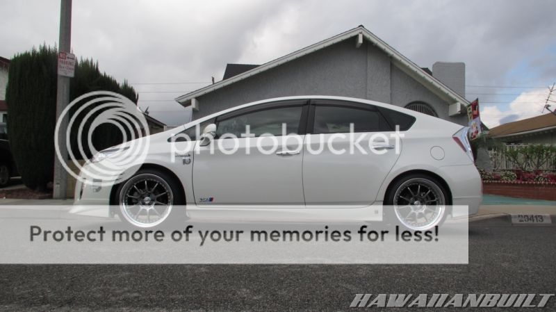

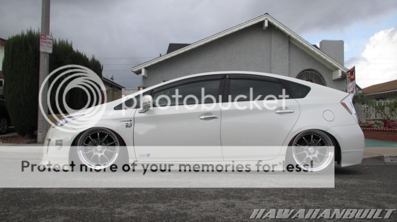

  12. HAWAIIANBUILT
    HAWAIIANBUILT Senior Member
    Sep 17, 2010
    824
    791
    69
    SO CAL
    HELLO BREITRTHNU !!!
    Sorry for the delay, finally had a chance this gloomy So Cal afternoon to shoot you some of the pictures you requested !!! I've also included measurements for your reference as well !!!
    Full Air UP
    Clearance Specs in Inches :
    Front Lip : 5.25"
    Front Side Skirt : 5.5"
    Rear Side Skirt : 5.5"
    Rear Lip : 7.0"
    Front Tire to Side Fender : 2.25"
    Rear Tire to Side Fender : 2.0"
    Full Air DOWN :
    Front Lip : 0.5"
    Front Side Skirt : 1.25"
    Rear Side Skirt : 2.0"
    Rear Lip : 3.75"
    Front Tire to Side Fender : 0.0"
    Rear Tire to Side Fender : 0.0"
    ** My Driving Height for HBII is at 50 PSi all around **
    Picture Comparisons :
    Full Air UP :
    100 PSi
    Full Air DOWN :
    0 PSi
    Hope this helps !!!
    Happy Holidays !!!
    Rodney
