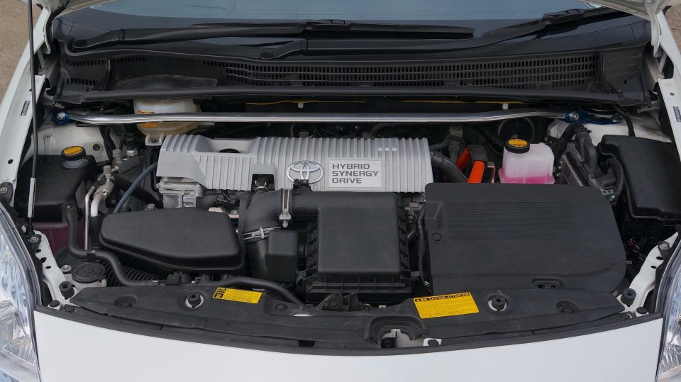

    You can simply get them from your Toyota/Lexus dealer as they are off a Lexus LS200h, or from here http://bit.ly/15IYrbp
    As the Lexus engine bay is a slightly different shape the inverter cover doesn't fit we'll towards the front so the best way is to remove the plastic section that covers the radiator and shave off the underside where the lip is and then this cover can tuck under nicely and clip in perfectly. Here is my engine bay. image.jpg
