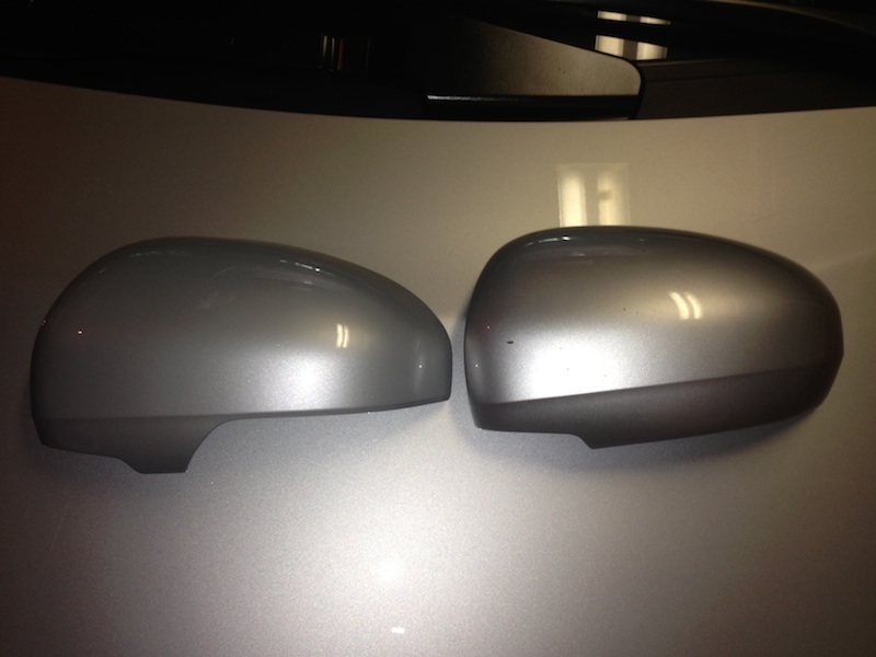

    One concern I had is how closely the paint color would match the OEM paint. This is not a great picture, but I could hardly notice the difference side by side while on the hood of my car. When they are installed, you'll never be able to tell the difference. I doubt if most normal prius owners would even notice you had blinking mirrors!

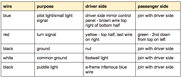

    After reading all the threads, it may be confusing on which wire goes where. I created this little cheat sheet to ensure I was connecting the right wires. Obviously you can test as you go, but this helps a little:

    • The blue wire in the a-frame was a pain in the butt for me. First of all, I was nervous about playing near the airbag. Really, there is nothing you can do to really screw it up, but getting to that blue wire is not a slam dunk either. You have to remove the tape around it and then fish it out because it's behind some of the wires. Once you create a little slack, you should be able to tap into it. I didn't use a T-tap and used this type which was easier for me.
