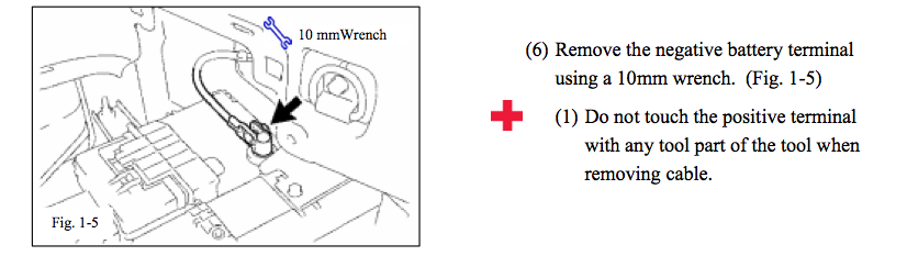

    Question... is it really ok to just disconnect the negative terminal of the battery? Not the positive? Just seems like it ought to be the positive, though I'll follow the official instructions (nervous about that airbag going off).

    The owner's manual is confusing but yes, you remove the negative terminal, being careful not to touch the positive terminal.
