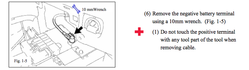

    I can't figure any reason why this would be the steering wheel replacement if it's installed as directed and the wheel is not off from the get go. Not that I think you did anything wrong.
    How much re-programming has to be done after detaching the battery like that? Auto Windows? other stuff?

    Just a simple clock reset. No auto windows, etc. and I didn't lose my single beep while reversing. You lose your saved trips though.
