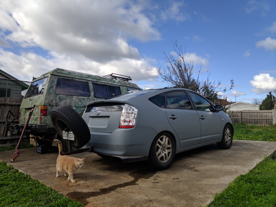

    Well that didn't last long, I've already cut it up and made a new square frame similar to the hitch racks a lot of people on here have.
    It still takes 10 seconds to slide into the hitch receiver, but now has the added bonus of being very versatile for anything I need to carry rather than just a spare wheel like I had before.
    I still need to get some steel mesh for the top, and some eye bolts for around the edges to strap things to, then paint.
    I also need to remove and paint the towbar, and run the wiring for trailer lights while the bumper is off. I may even put some lights or reflectors on the hitch carrier also, in case I put something too big on and cover the tail lights.

    This wheel and full fuel can are probably under 100lbs together and my hitch is much more robust than the CURT ones as it uses the factory bumper reinforcement mounts as well as the tow hook mounts they use.
    I will keep an eye on load weights though, regardless of tow hitch strength having that much weigh sticking out way behind the rear axle is no good for handling.
    Thanks, il give the oil a look.
