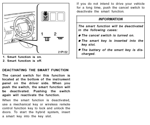

    What's SKS function and how do I turn it off?
  12. SFO
    SFO Senior Member
    Feb 7, 2017
    5,302
    4,251
    Northern California
  13. P08A80
    P08A80 Junior Member
    Feb 14, 2020
    22
    Fremont, CA
    I see. Thanks for the info. I will turn it off once the car starts running, although I suspect that it stopped working already or maybe it was accidentally shut off.

    Does the FOB lock/unlock the doors when you press the buttons?
    Before turning the SKS off, test the physical key (contained inside the FOB) and make sure it locks/unlocks the drivers door.

    The buttons on the key stopped working a few months ago along with the auto unlock when near car feature. I had to take out the key physically to unlock the door every time. I don't know if the key/fob broke or it was accidentally put on SKS but I'll check.

    Just checked and SKS was on. The key fob battery is new. The key fob stopped working after being exposed to water one time and became less and less responsive until it stopped working altogether.
