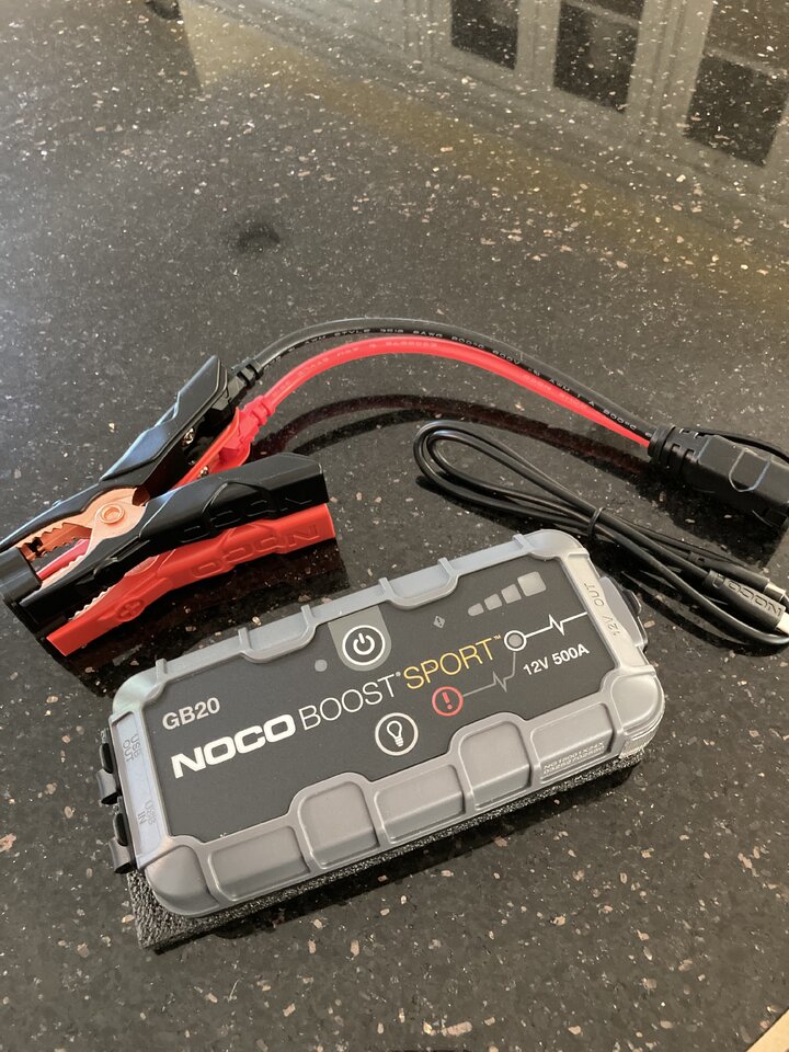

    Looking to buy a jump starter device for my prius. Leaning toward a Noco Boost NOCO - Lithium Jump Starters since I have a charger from them and think it's good.
    Couple of questions:
    1. What's the best size device for the prius? I've seen several folks have the GB40 but that claims to be able to jump up to 6L gas engines. The smaller GB20 says it can handle up to 3L, which should be enough for a prius. Is there a reason I would need the GB40 for the prius? Or would i get need it only if I also want to be able to jump vehicles with larger engines?
    2. What's the procedure for a successful jump in the front of the vehicle with one of these devices? They have very short cables, so I can't attach to the two jump points recommended in the prius manual, which are on opposite sides of the engine compartment. Do I need extension cables? Has anyone successfully used one of these with alternate attachment points in the front?
    Thanks!

    Video procedure here, NoCo cables will be long enough. GB40 only $20 more than GB20.

    Best place to attach is the jumppoint of course and for the ground use the bare bolt right above it that’s one of the 3 strut bolts.
    Used both of those for years using a charger for remedial battery maintenance,
    Be aware the jump point is a flat metal tang mounted vertically so you can attach a jaw.
    mscholtz likes this.

    The littlest one, GB10, is adequate for a Prius.

    I don't know from Noco model numbers, but the jump pack I currently have holds 38.4 watthours, and before it I had a slightly smaller one at around 30 Wh.
    I don't pay much attention to the big flashy numbers for peak current (hundreds of amps? thousands of amps? you need tens of amps to start a Prius), as I think the total stored energy, watthour figure is more relevant. Sometimes the watthour number is much harder to find on the packaging (sometimes not on the outer packaging at all).
    My 30 to 38 Wh units have no trouble starting a Prius, except in the case where the Prius's 12-volt battery is extremely discharged. An extremely discharged car battery can suck all 38.4 Wh out of a jump pack in less time than it takes me to duck in the driver's door and try to push the power button. Result is then a fully-discharged jump pack and a car that's still not started.
    When the situation is one where I think that might happen, I disconnect the car battery first, then use the jump pack to get to READY (no problem then), and then reconnect the dead car battery and let the car charge it.
    In gen 3 that's quite easy to do (you can disconnect the car battery by unplugging a fat white connector right in the underhood fuse box). In gen 2 it's less convenient (there's an unpluggable battery connector, but it's buried in back where the battery is). But it can still be worth doing if you're in a situation where a drained jump pack would be really inconvenient.

    that's why i bought this one instead of the GB 10, it has an override button for batteries discharged below 2.something volts

    Yes, you definitely need one with such an override button to be able to jump with the car battery disconnected—otherwise, of course, it will see zero volts and refuse to jump.
    Another thing you can do with such an override button is push it and try to jump the car while the car battery is still connected and really below 2.something volts. But that's the kind of situation that's most likely to slurp all the charge out of the jump pack in the time it takes you to move from pushing the override button to pushing the power button, and leave you with a fully-discharged jump pack and a car that still needs a jump.
    So my rule is to disconnect the car battery first in a situation like that.
    (Not so with conventional cars: conventional alternators / voltage regulators needed the car battery connected at all times.)

    Well, if you're talking about a gen 3 plug-in like your profile says, the "necessary tools" are one hand with a finger and an opposable thumb. You squeeze the connector tab on the fat white cable in the underhood fuse box and pull the connector out, and the battery is disconnected.
    Back in gen 2, it was more effort, because you'd have to dig out whatever cargo you had in the back, and lift up the deck board and the storage tray to see the battery, but once you get there, once again there is a fat cable with a squeeze-and-pull connector and poof, the battery is disconnected.* I don't know the exact story for later gens.
    Well, the Prius batteries tend to be around 45 amp-hours or, at 12 volts, 540 watthours. So my little 38.4 watthour jump pack is about a fourteenth of that, and clearly that's small enough to disappear quickly into the drained battery and not make much of a difference.
    Just what fraction of 540 watthours would be enough to dependably make a difference, I don't know. Half? A third? A quarter? Those would suggest a pack anywhere from a few times to several times the weight and bulk of mine.
    * that said, while I've used this technique multiple times with success in gen 3 and gen 1, I'm not sure I've done it in gen 2. Gen 2 is reported to throw errors if its remote-sensed voltage reading seems suspicious—which it will if the cable is unplugged—so that might throw a wrench in the routine for gen 2.
