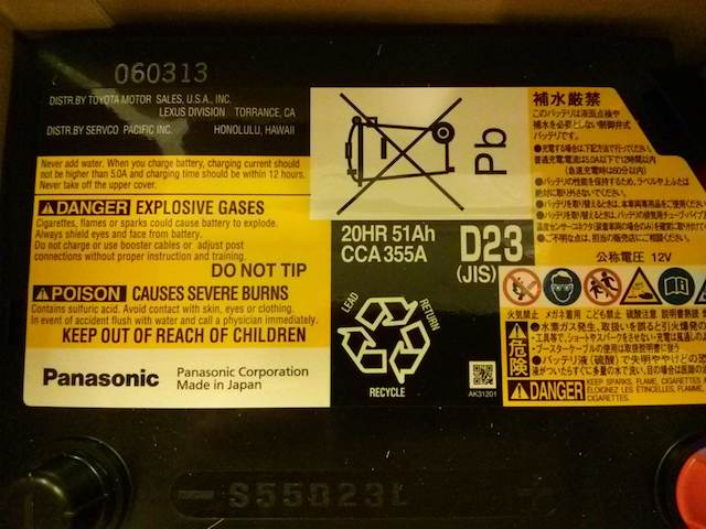

  14. ChapmanF
    28,721
    19,020
    There, see how it happens? You sit down at the keyboard, determined you're not going to write one of those fanatical PriusChat opinions, and by the time you're done, just because of a simple detail like getting the comparison between the two battery types backward, you end up having written one anyway. ;)
    A low-CCA, non-starting-duty battery is more robust and less easily damaged than the high-CCA starting monsters, not the other way around.
    Here, let's look at the one in my Gen 1.
    Gen 1 Prius had two aux battery options; this is the larger one, still pretty modest as car batteries go.
    The two numbers that matter (as Mendel pointed out upthread, don't mix them up) are the 51 amp-hour energy storage capacity, and the 355 cold-cranking-amps, measuring its peak ability to deliver power for a few seconds when really cold. (Really cold is the worst case, at comfortable temperatures even this battery will deliver much more than 355 amps, and get your tools or your watchband pretty hot if you're not careful).
    So what do you change to turn a battery like this into the kind of 800 or 900 CCA monster you might see under the hood of a truck? Well, you want to roughly double its peak current capacity. To do that, you double the surface area where the chemicals can react, and to do that, you make it with twice as many lead plates, and you make those plates twice as thin. That's what makes high-amp starting batteries such lousy energy-storage batteries.
    Well, hold the 'phone ... I seem to recall, what the battery manufacturer stated was
    Now, that could mean a couple of things.
    1. It could mean "hey, don't try to draw big starting currents from this battery, because it'll self-destruct."
    2. It could mean "hey, don't try to draw big starting currents from this battery, because you might not get them."
    It happens to mean (2). The battery won't be harmed in the least by the fact that you wanted 800 amps and it only gave you 400. It will look at you calmly and say "what? My label says 355. You wanted maybe a miracle?"
    Now, if you don't take the hint, and you keep trying to crank over your Mack truck until the battery's stone flat, and then you hike off into the snowy wastes for help, and you don't get back before the now-depleted electrolyte has frozen in the cells ... yeah, that will have harmed the battery. But just not-giving-you-as-much-current-as-you-wanted will not have.
    Don't forget that in warmer weather the capacity is higher, and also engines are easier to crank. I've easily started a big ol' Isuzu SUV a couple times in winter from my Gen 1 battery.
    The key is, you just don't want that current to be coming from your DC/DC converter, or through the converter cable, which has only 100 or 120 amp fuses in it. I just unplug that cable from my battery before the other vehicle tries to start, then plug it back in. It's easy in Gen 1 because the cable really does unplug, right at the positive battery post. I think it's the same in Gen 2. I made the mistake some months ago of trying to convince a Gen 3 owner it was that easy, but apparently Gen 3 did away with the plug, which irks me. If I ever buy a Gen 3, I might add a plug. :)
    As you see from the date stamp, my current battery was made in 2013. It replaced the one that was made in 2006, and that one was still starting my car just fine. The ten year old one is living a peaceful retirement in my basement on a maintenance charger, just in case I ever need a spare for something. The other day I unhooked it and used it to fill a 10 gallon air tank to 120 PSI with a 12 volt compressor. Never dropped below 12 volts, and read 75% capacity when I was done and put it back on the charger. I can't say it's given me much to complain about.
    -Chap
