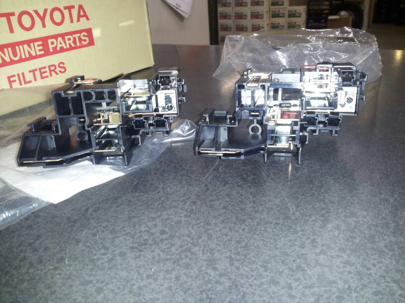

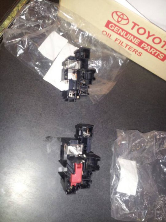

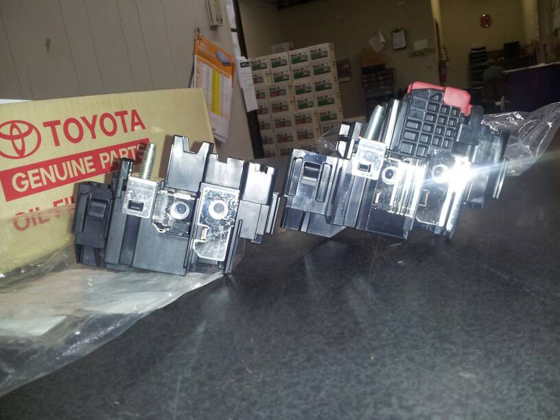

  17. toyotechwv
    toyotechwv Toyota Technician
    Nov 16, 2007
    474
    251
    Princeton, WV
    Ok guys, the other relay block finally arrived. Here are some pics of both side by side. One without jump terminal, one with.

    production date 2/13 and + terminal is under the hood in the drivers side fuse box as shown in the image earlier
