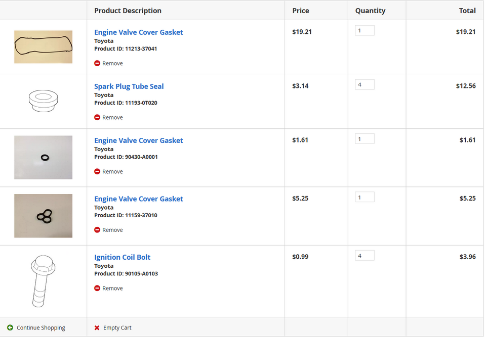

    Sorry haven't been checking the thread. After giving my best efforts to extract the bolt and learning a lot about bolt extraction lol. I found the valve cover Gasket on ebay for 48$ total and ordered that. Now waiting on the gaskets to come in. Just moved into a new house so still getting my Garage/Shop sorted out and organized. I paid 6750$ for it and the only reason for that was due to it having the Advanced Tech package,being a five level trim and a later year of the V. Basically the configuration I've been drooling over for the past couple years. Also I want to get more involved in learning the fixing and repair of cars so it being too good to be true didn't bother me too much. Even if I have to drop a new engine in it I think I'll still be ahead considering the price, knowledge I'll gain and fun I'll have.
    Dropping the order that I've pieced together for those kit's as it appears Fel Pro messed up from my research and made the spark plug tube seal too large, and if I can't pick it up today might as well go OEM
    Engine Valve Cover Gasket
    Product ID: 11213-37041
    Spark Plug Tube Seal
    Product ID: 11193-0T020
    Product ID: 90430-A0001
    Product ID: 11159-37010
    Likely won't need this bolt but I'll drop it anyways lol
    Ignition Coil Bolt
    Product ID: 90105-A0103
    This is on the website "Toyota OEM parts online"

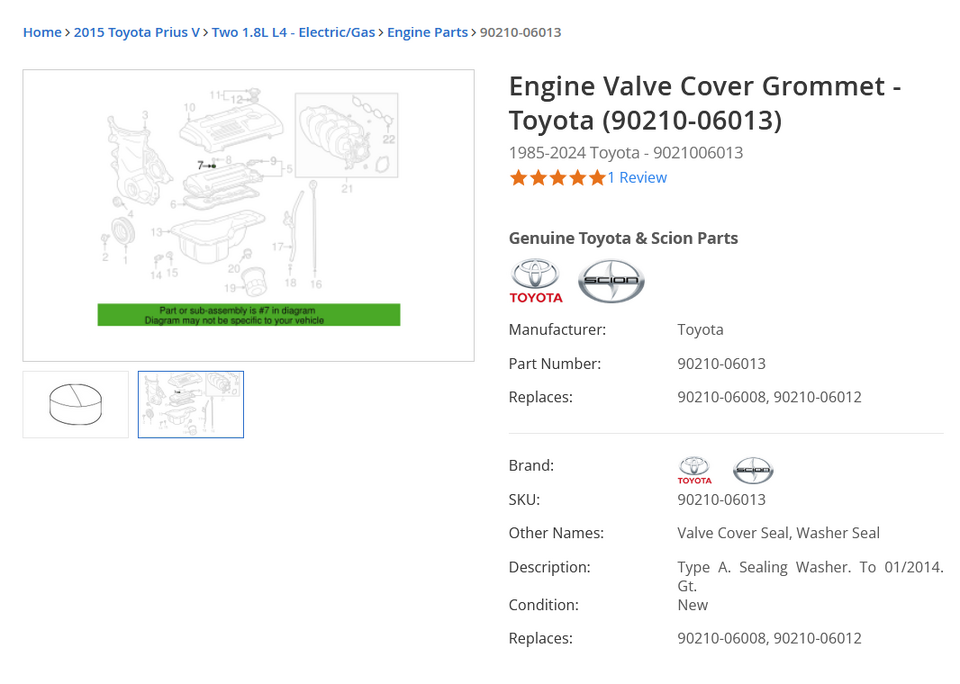

    Was watching a video and saw they had one more grommet for a bolt. I'll let y'all know if this one fits. This for the bolt near the hole you add oil is.
    90210-06013
