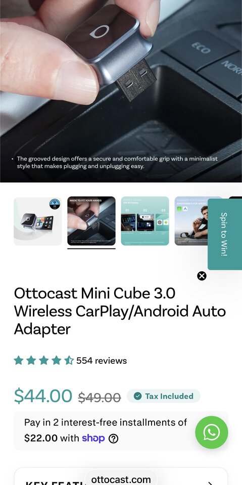

    In a 2022 you can buy an adapter from Ottocast that plugs into the usb and makes Carplay/AA wireless. I use one and it works fine. No big issue with phone battery unless you are on a long trip. In that case I plug the phone in as needed.
