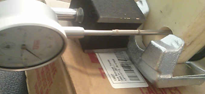

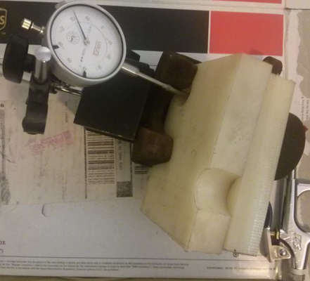

    Here are a couple of pictures of measuring piston return:
    A dial indicator from Harbor Freight, eBay, etc. is cheap, and the only other prop is some block or blocks of hard stuff (I used a couple nylon blocks I had around, but it doesn't matter) about as thick as the rotors with pads, with a hole drilled through for the dial indicator stem to rest on the piston.
    The trick is not to apply a lot of force during the test (a brake caliper makes it easy to apply a lot of force!). The point is not to test how much the blocks will squish or the caliper will stretch, but only to gently extend the piston to where it lightly taps the blocks, then note how far it relaxes. A gentle puff of air into the caliper from a bike pump is easily enough.
    A couple years ago, a poster discovered his phenolic pistons had swollen (rebuilding the caliper, after getting them out, they wouldn't go back in). That doesn't seem to be your issue, as you make it sound as if they move easily, but another thing to watch for. Pistons aren't included in the rubber kit, might add another $16 or so if needed, if I remember right.
    The big auto stores sell complete 3rd-party remanufactured calipers, but the last one of those I tried had zero piston return right out of the box. :mad:
    -Chap
    Edit: the pictures above show the magnetic dial indicator base stuck right to the caliper, which was easy for Gen 1 because those calipers are cast iron. Naturally, it won't stick like that to an aluminum Gen 2 caliper, so a little more setup would be needed.
