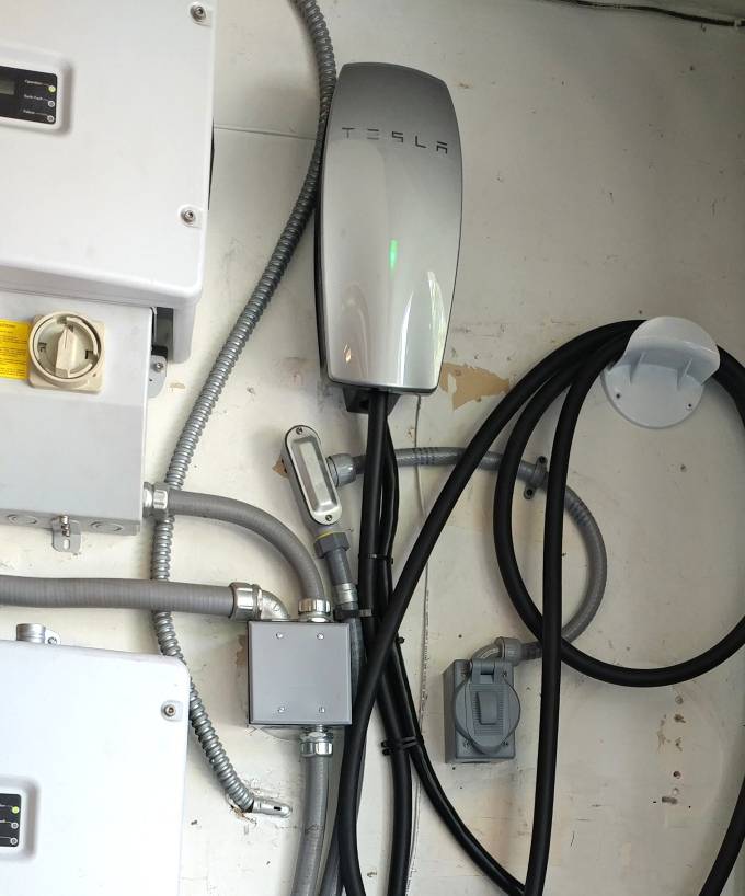

    We sold our aerovironment evse & opted for this bad boy ......
    ...... which will go all the way up to 80 amps 19+kW - but i programmed it to go no higher than 72 amps, & I used a run of 6 gauge wire - even though we almost never charged abive 50 amps, with the Tesla's that we unloaded over a year ago.
