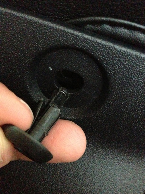

    Also, on the rear bench, the little plugs that they tell you to remove. I can't get them back in. It's almost as if they're a "one use only" deal. Might have to go to the dealer tomorrow to grab some new ones.

    The ones that hold the plastic panels below the rear seat in place? You push the center rod in to remove the clip, then to put them back you push the rod as far as it will go in the other direction (out through the face of the clip), put the clip back in the panel, then push the rod in flush to secure it.

    Perhaps I'm just really dumb, but I tried that and it simply will not work.

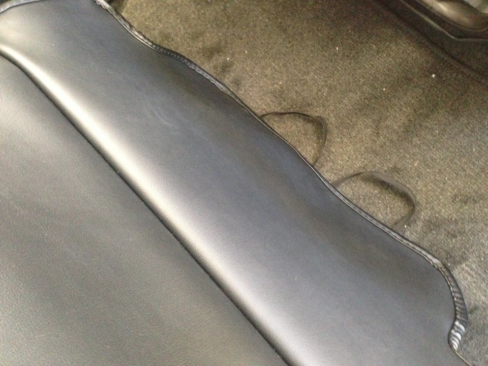

    ImageUploadedByTapatalk1375142869.528227.jpg ImageUploadedByTapatalk1375142896.224161.jpg
    Couple of pix for reference. Can i get these at the dealer? I broke one trying to get it in.

    yeah, those things are the devil!
    sometimes when I go crazy after trying and trying, I end up removing the pin and pressing the bottom part in and then inserting the pin separately.

    you can try your local autozone/pepboys. they usually have those fasteners.

    In your second picture you need to pull the center pin further out, so as to leave room for the four tabs to go back in the hole. Then push the pin back in to secure the fastener.

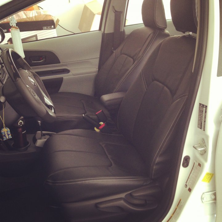

    Pretty good fit and finish. I would have preferred the oem softer but at least these could be custom.
    Black PVC with grey stitching
