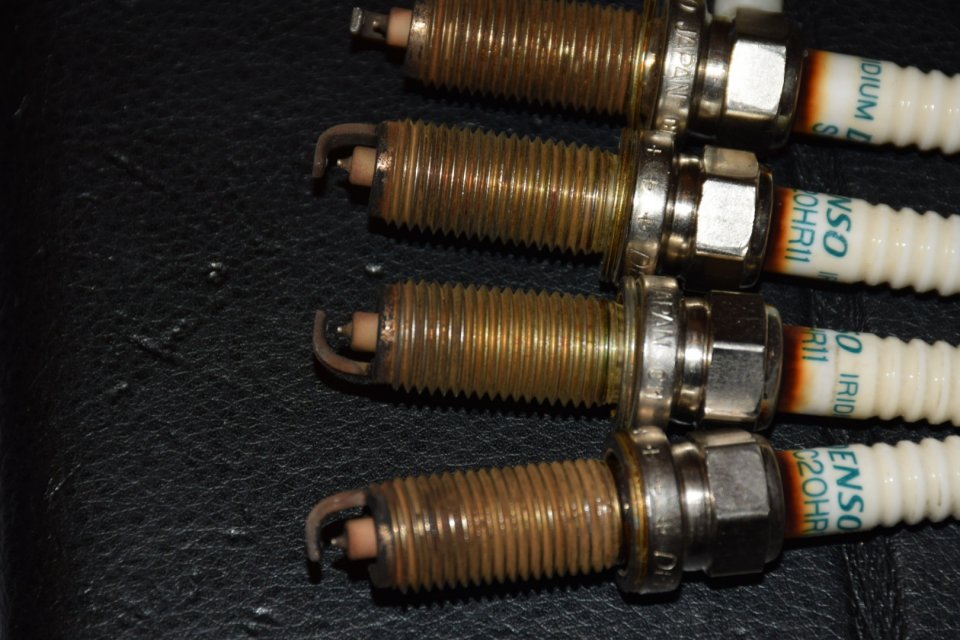

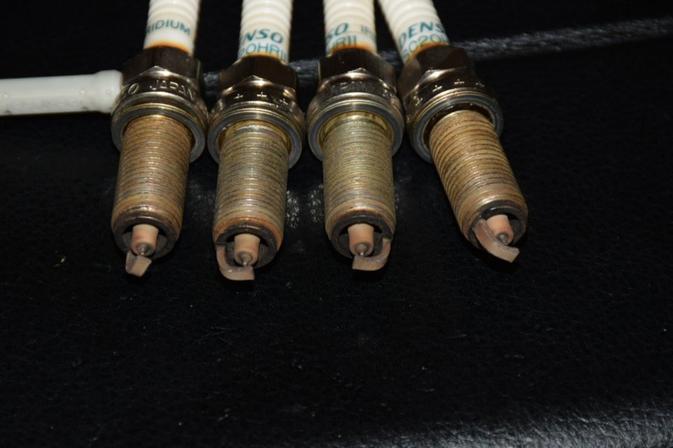

    Denso SC 20HR iridium11 plugs are good after 100k(km) as pix . Does any one know why the white porcelain portion of the plug have brown rings around it ?

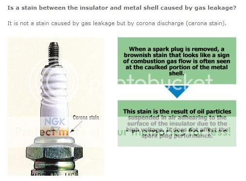

    Corona stain:
    citybug and xliderider like this.

    Thanks , Friendly_jacek . I was a little worried earlier .
