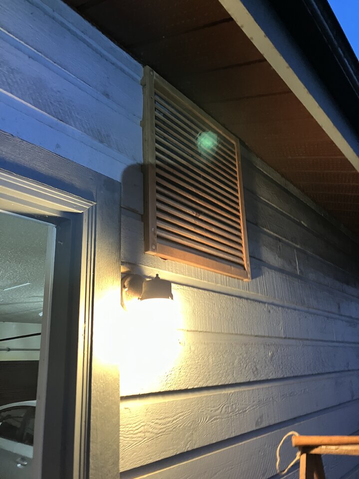

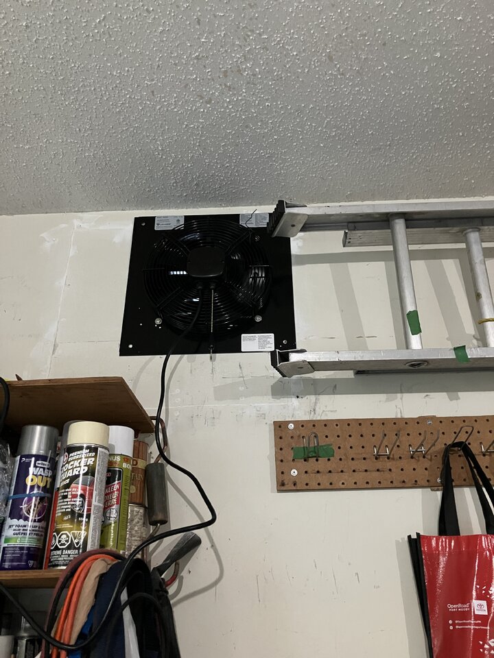

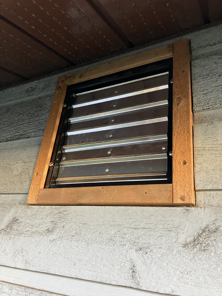

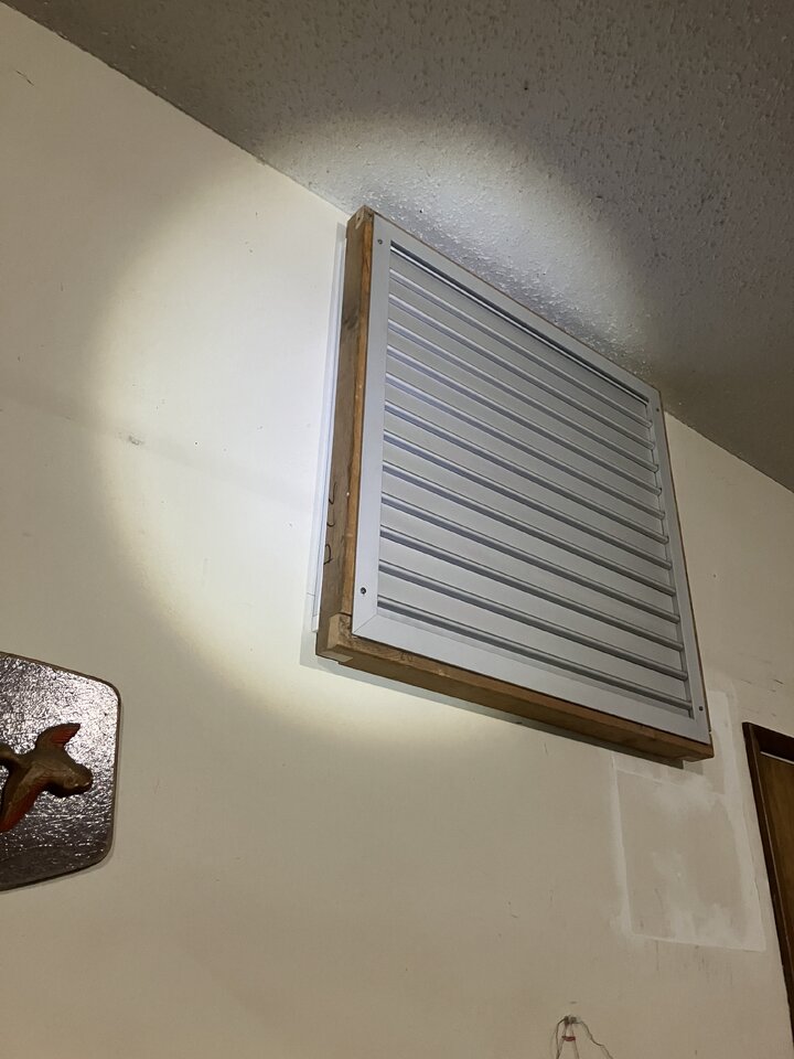

    We've got a freezer in the garage too. Just acquired recently, and was somewhat instrumental in my reno's: our garage has west facing double doors, and while we've upgraded from solid wood to insulated, steel-sheathed doors, it's still gets moderately toasty in summer. I've installed an in-wall, 1100 CFM fan with magnetic/gravity shutters, and a make-up air grill as well.

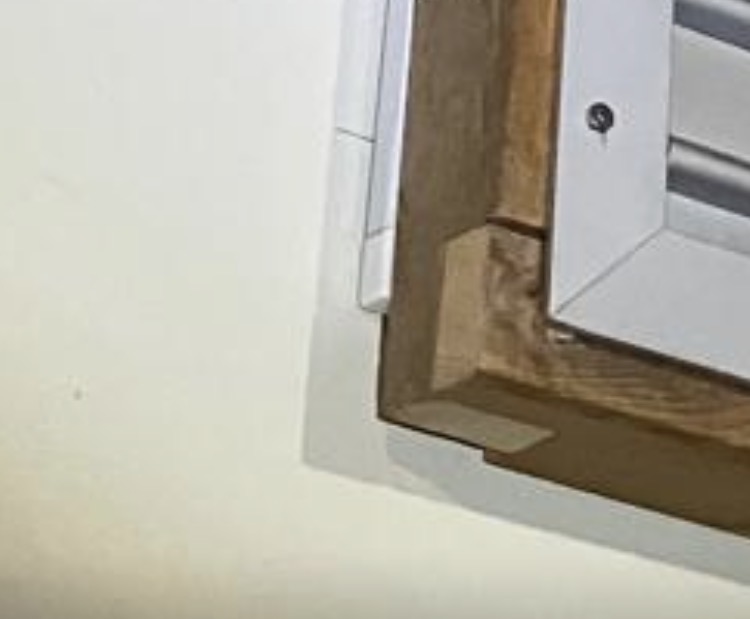

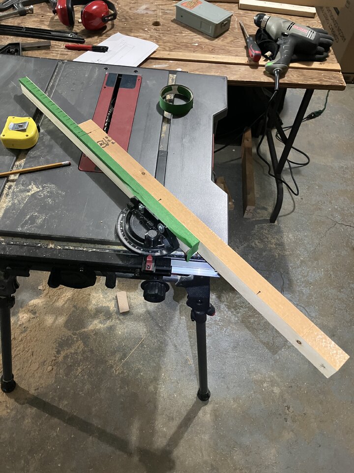

    With only 2 floor-level outlets, it was bugging me, having a long, funky extension cord to the fan, decided to add an extra outlet, convenient to the fan. Plus a thermostat. Cobbled frames for all, the make-up air grill, on the inside I caved and purchased a gravity shutter fan, and made it a frame proud of the wall, with a pocket for bug screen. On the outside I ended up making a grill, with rodent mesh on the back.
