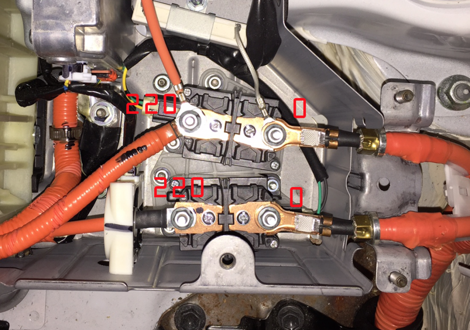

    Tested and replaced 2 bad battery cells in my 2007 Prius... Got everything put back together and now all dash lights are on and engine won't start... When i try to shift into drive or reverse it goes directly into park... I tested the battery without removing the safety key and the inside terminals are at 220 volts and the outside terminals are at 0 volts as shown by photo... Any thoughts from the experts here on PriusChat?? Maybe a fuse somewhere?? Im going crazy.

    The orange safety plug needs to be pressed downward to lock it into place. Then try to start again

    Yeah im a idiot... I forgot to press it down to lock it... 1000x thank you JC91006... Works perfectly
