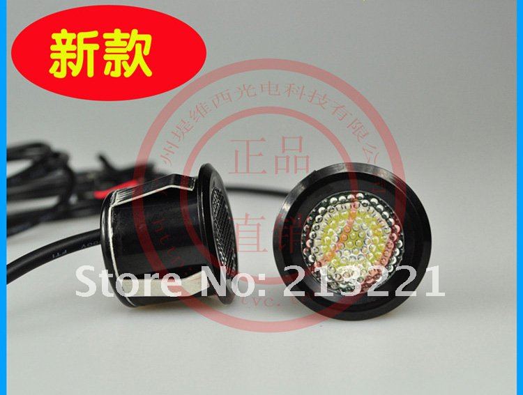

    Puddle lights installation.
    Thought This would be a good place for the lights.
    Found these: Aliexpress.com : Buy New !!! 9W High power IP68 DRL Daytime light Reversing Radar shape Eagle eye Led Rear backup tail lamp Full Aluminum body from Reliable daytime light suppliers on Easylink Technology Co., LTD

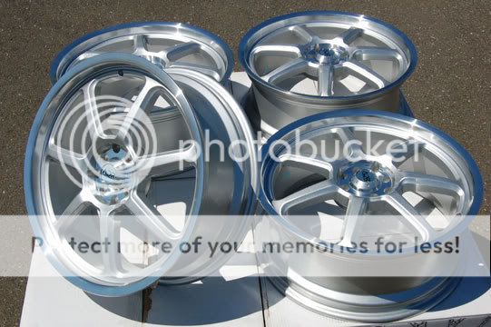

    ADR S07R Wheels
    19x7.5
    42mm offset
    73mm bore
    Sunny Tires
    SN3970
    215/35ZR19
    420 A A
    Currently running with no spacers on my GC coil-over sleeves.

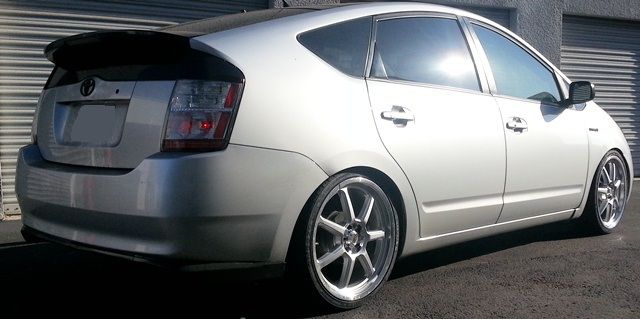

  10. Justdidit
    Justdidit LVNPZEV
    Jun 12, 2012
    1,880
    710
    75
    Carrollton, Texas
    Four Touring
    'Rollin on rubber bands...' - yup! Car corners even flatter than before... Have noticed a 3-4mpg loss - mainly city driven - highway not nearly as impacted...but soooo worth the look considering I'm still whooping most non-prius family cars on the road for mpg still!...
