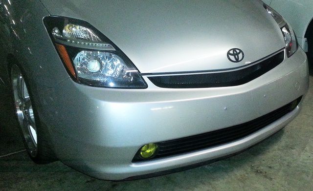

    Last DIY Mesh grille mod b4 the wreck:

    Glad you are OK but sucks about your car
    Can you post details on the mesh grill install?

    Not much to it really, with the bumper off the car, I used a hacksaw blade to cut out the OEM grille and a dremel to smooth up the edges. Bought some cheap gutter guard from HD and used a rivet tool to fasten the gutter guard to the bumper in the grille area. I used PlastiDip to paint the surrounding area. Liked the look - much more aggressive.
    Before PlastiDip
    After PlastiDip
