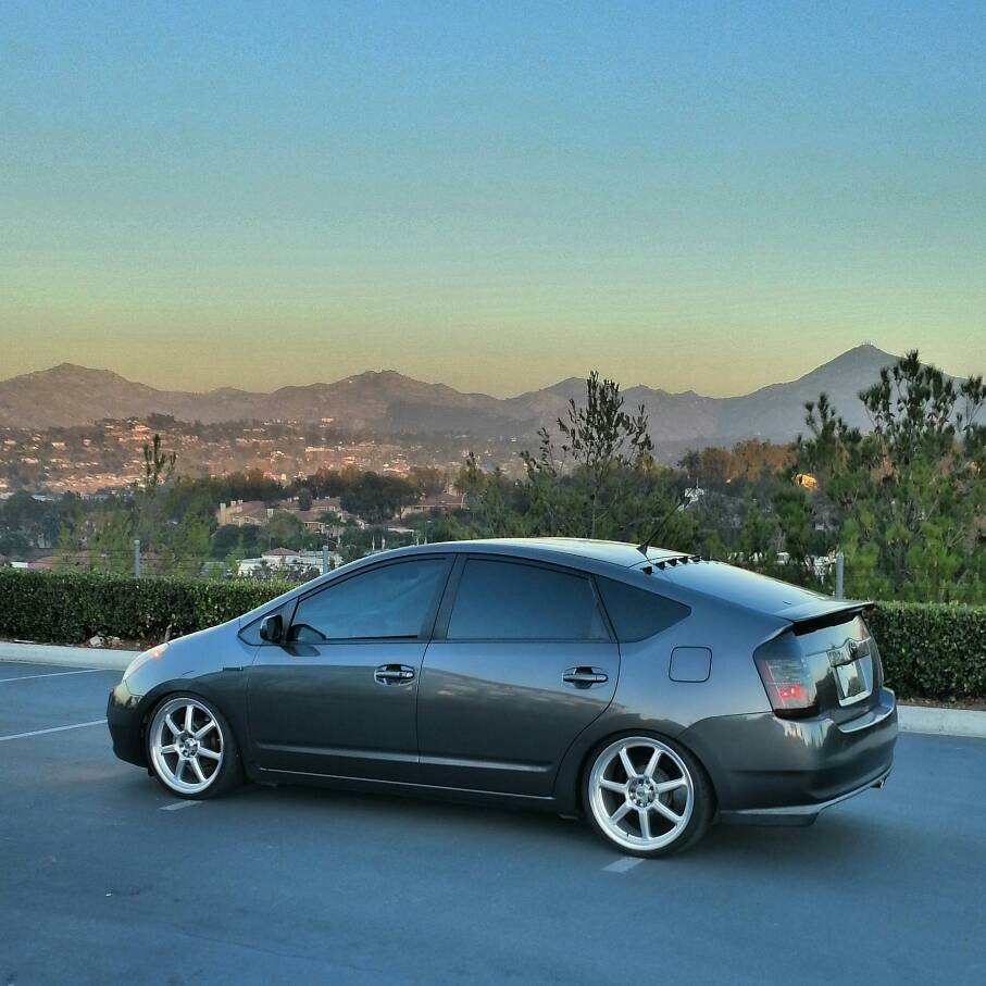

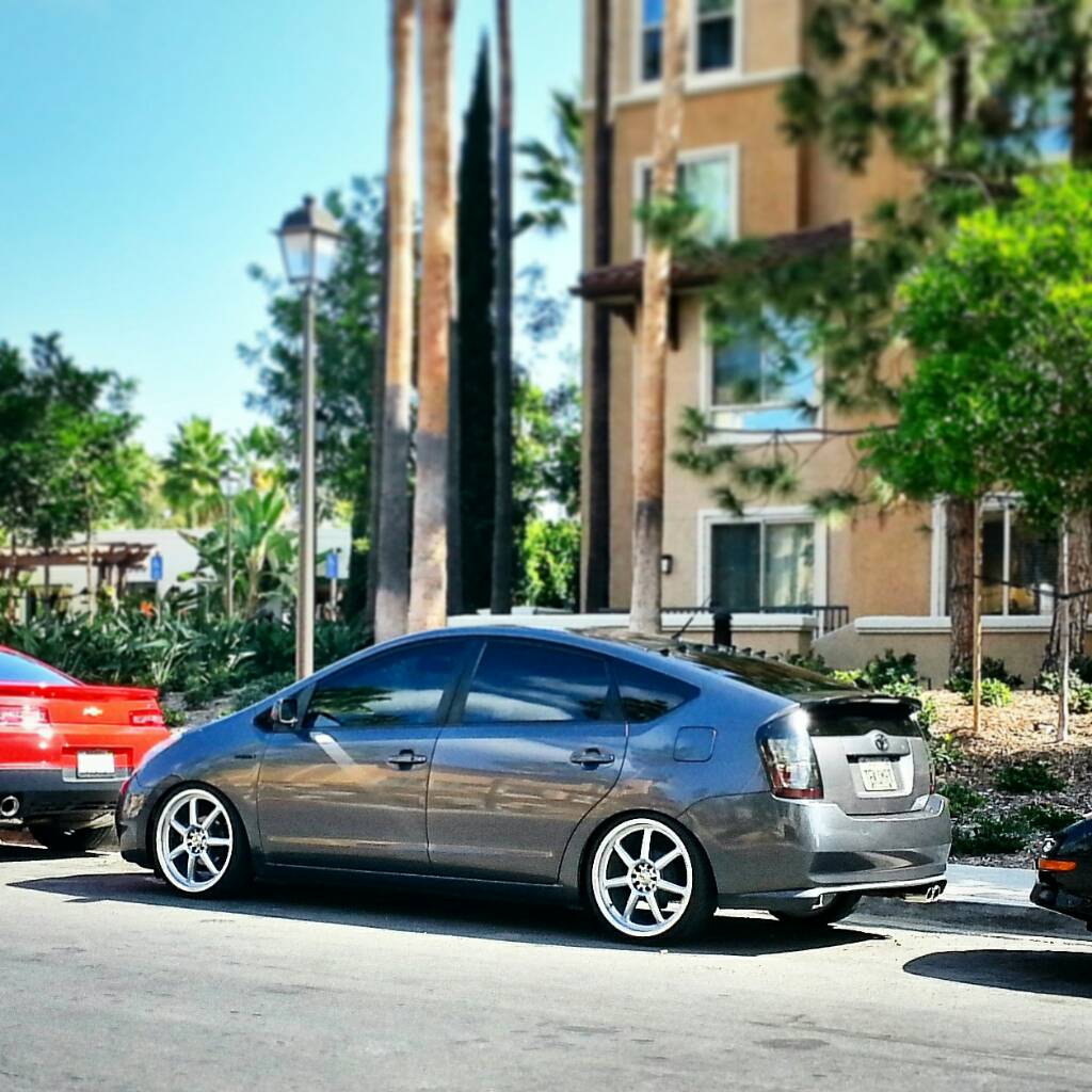

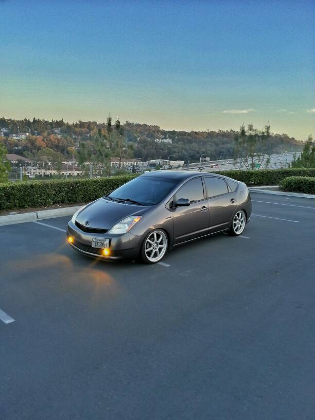

    Which should i go with? Silver or satin black...
    Having new tires mounted and will either peel off the plastiDip... or redo it.

    Silver or experiment with a dark bronze or dark gold dip, it could look really good with your paint.

    silver from me

    Kinda over the satin black. Possibly silver..or gold plastiDip would look good...or smoked silver plastiDip color similar to my headlights.

    Silver.
    Looking good.

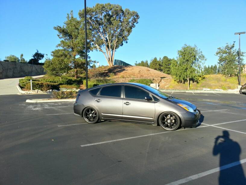

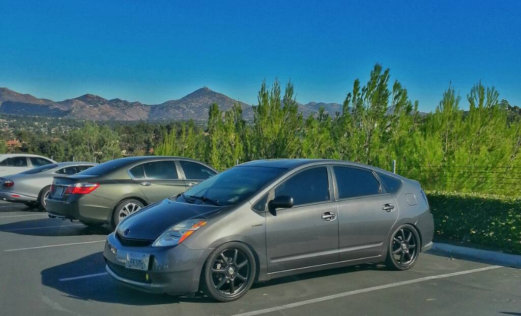

    I like the black better against the dark grey paint. Did you lower this vehicle at all or you sitting on 19's with 35's without it dropped? I'm trying to figure out the best size wheels/tire combo for my 2014 PiP to fill out the wheel well as much as possible without lowering it. One site wheel fitment site suggests that 20's with 35's would actually fit.

    Dropped ~2"-3" ( haven't measured) with 215/35R19 tires - 19x7 wheels - No rubbing at all.
    Not sure what it would look like with 20s and no suspension mods..

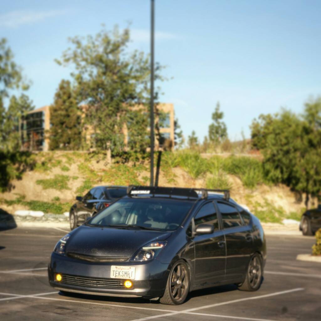

    Here is a G2 'Slammed' on 20's beside it is a G2 with 19s
    Good luck finding a 215/35R20 tire... I could only find a 225/30R20 and this was the size difference
    You MIGHT make it work with no modification to the fenders...
