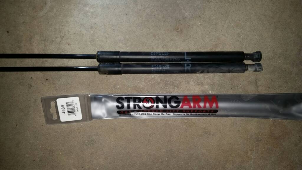

    Installed 'Strongarm' rear hatch shocks the other day after my old ones were failing. Not always staying up. 'don't you hate that...'
    You can find them for less than $20 on the 'A' word site.
    Old ones wouldn't hold the rear hatch up...let alone lift it like these do.
    I don't think these are specific to the Gen2 Prius - I had to rotate the head of the shock 180 degrees as it was facing the wrong way - other than that - straight bolt on.
    #324 Justdidit, Jul 20, 2015

    That's an awesome find! You're right, I don't think they are specifically for a GEN II, when I go to that 'A' site, it states that this will not fit my 2009 Prius, but of course it wouldn't, it says they're hood-lift-supports! I checked RockAuto Parts Catalog and the only real quality lift-supports were listed at $32.00 each! So yeah, I'm defiantly adding those StrongArm 4686 lift-supports to my "A-Zon" 'Prius Parts and Ideas' wish-list.
    Thanks for sharing the info!

    Just remember - I had to rotate the head of the shock 180 degrees as it was facing the wrong way - other than that - Straight bolt on. Super StrongArm. :) Super cheap compared to OEM.... and stronger then oem replacments. PartsGeek had some other options - but i'm def happy with my purchase.

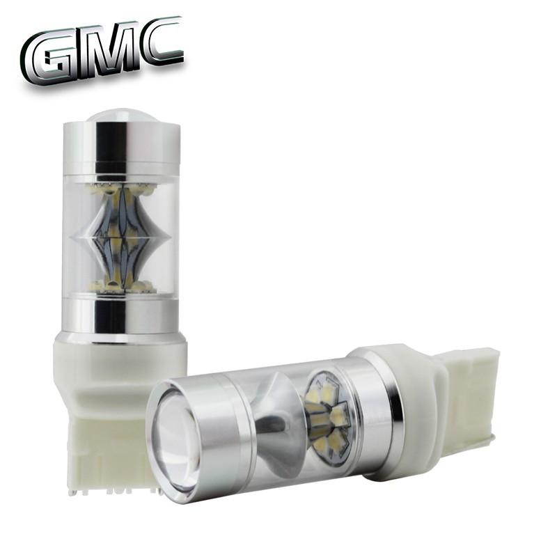

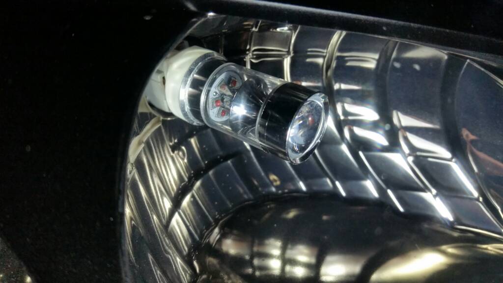

    Installed some new turn signal and backup LEDs - Factory direct sell 75w 7440 DT20 Auto LED Turn Light, View car led lights, GMC Product Details from Huizhou Gmc Car Light Co., Ltd. on Alibaba.com
    Contacted - 'Memory'
    Memory
    Huizhou GMC Car Light Co., Ltd
    Tel: 0086-07525775420 Mobile/what’s app: 008615999664637
    Email :[email protected] Skype: [email protected]
    Website: Huizhou Gmc Car Light Co., Ltd. - led light,car lights
    They are definitely brighter than 60W I was using. I think because of the new reflector design, the lights appear brighter.
