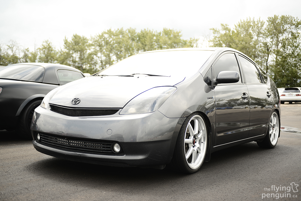

    Took off the 17" snow tires and threw on the 19s. Added another coat of Canadian version of PlastiDip called ProtectDip from CanadianTire store. Gloss coating makes it easier to keep clean and from looking so dull.

    Looks really good, are those VOLK rims?

    Nah, just some cheap and heavy ADRs
    ADR S07R Wheels
    19x7.5
    42mm offset
    73mm bore
    I keep flip-flopping on the silver or black color....

    Ah alright, personally I think the car looks better when they are black. I am hoping to get some Sparco wheels or Advans soon.

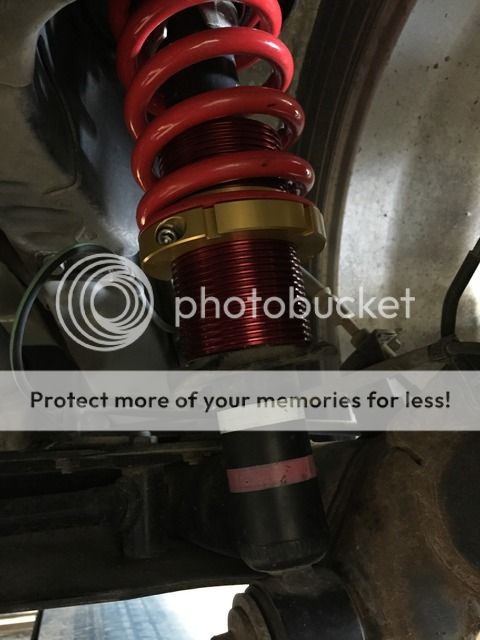

    Are you having any issues with the rears making turns or going over bumps? Installed mine tonite on stock struts and it clunks and bounces like crazy in the rear.

    What exactly did you buy? I have modified my setup from the 'out-of-the-box' kit. Also do you have any pictures of your setup? Does your setup look like the photos I have posted here? NHW20 Ground Control, Bilstein and KYB suspension upgrade | PriusChat

    Ok I have the 03-08 Matrix/Vibe GC coilover sleeves PN# 8070. With spring rates of 8.2kg(450lb/in) in the front and 6.7kg(375lb/in) in the rear. Im current running stock struts since they only have about 66k miles on them. Ok I think I might have solved the problem in the instructions it says remove the spring perch. I did not remove my spring perch because there is no lip to hold the sleeve like in the directions it would slip all the way down the strut. So the sleeve is on the spring perch which is making it sit at an angle and hitting the spring over bumps. So how were yours on your stock shocks?

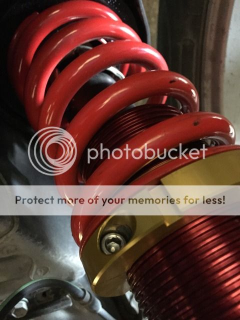

    Learn from my mistakes, take the perch off.
    1st time...
    What happened... the aluminum sleeve split/cracked over time from being mounted incorrectly.
    2nd time...
    3rd time
    Look close at the diameter of the strut casing and spring perch. Mine were Touring struts. Make sure yours are the same diameter and or have the metal ring for inside the sleeve to make up the difference.

    Ok the only thing I can figure out is Ground Control sent me the wrong rear sleeves because I can slide them all the way down the strut with the spring perch off.
