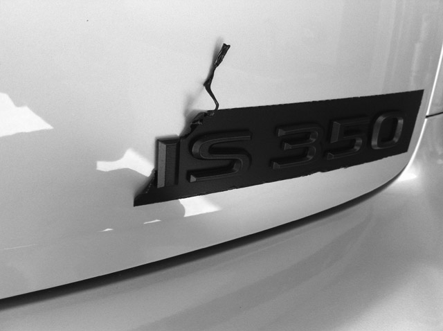

    Its an easy to use spray on.. Plasti Dip available at most hardware stores for ~$5
    Can be sprayed on and the excess peeled off with out worrying about damaging the factory paint. I didn't take any pictures of the process, but to give you an idea..
    I pretty much just taped off the area. Similar to the Lexus emblems below, spay lightly a few coats, let it dry then peel off the overs-pray.
    Here is the link to where I borrowed the idea...
    DIY - Matte Black Emblems - Plastidip, no emblem removal required! - Club Lexus Forums
