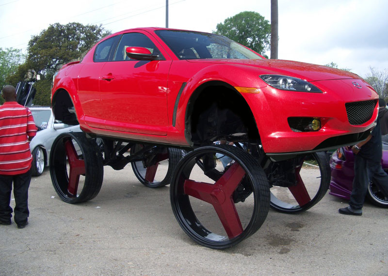

    Ya, I'd crack up also and laugh hysterically in disbelief if I saw something similar:
    ...Worthless...
