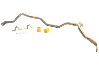

    thanks for the additional info man. been to a scrap yard today and as it turned out, the E130s with the 24mm bars never landed in Australia. Only the E120, 122, 123 were sold here and only had 21 to 23mm front sway bars, i guess, basing it on the D-bushes product codes. And all the gen2 prius here looks to be the touring edn with the 22mm front bars.
    NHW20R ToyoDIY.com
    ZZE122L ToyoDIY.com
    ZZE123R ToyoDIY.com
    ZZE130L ToyoDIY.com
    So it looks like i'll have to cough up more dough for this alternative: Whiteline BTF72Z 24mm adjustable sway bar. Whiteline BTF72Z Sway bar - 24mm heavy duty blade adjustable

    Ouch on the wallet...
    AU eBay - $202 with Free shipping to Sydney AU - Toyota Corolla ZZE120-130 series 02-08 Swaybar 24mm F | eBay

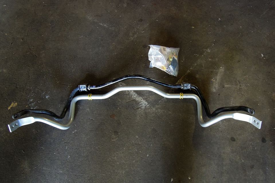

    Had the Whiteline swaybar installed already and BOY (!) did I feel a huge difference when i turn in a corner! The front felt much firmer and planted itself pretty well upon turn-in... and this is just on the soft setting (23.5mm equivalent or +29% stiffer). The hard setting is 24.5mm or 53% stiffer than stock (22mm). One note of caution though... this Whiteline sway bar (BTF72Z) for the ZZE122, 123, as it turns out, is not exactly compatible with our Prius! The diameter of the drop link bolts are smaller (10.7mm) vs 12.5mm in the Prius. It's a good thing my mechanic had access to an industrial drill press to bore out the spring steel to spec. Another note, I couldn't use (yet) the hard (24.5mm) setting because, somehow, the sway bar is hitting the steering arm slightly when the suspension is fully unloaded (wheel dangling). We need to clear the steering arm on the full range of motion. I think it can be done by trying to move the sway bar a tiny little bit to the front as there's provision for adjustment in the clamps. I'm taking it back on friday to my other mechanic who specializes in racing setups and ask for his opinion.
    In my opinion, though, the 23.5mm soft setup is already perfect. Another 24% stiffer and it wouldn't suit my current spring/shock combination. My front shocks wouldn't be able to handle the much stiffer ride. That's next in my to-do list.
    I have yet to test this setup on a track and in a safe wet environment to ascertain what kind of behavior this setup (23.5mm front / 24mm back) would give me. In hindsight though, a 22mm front /24mm back already gave me a slight momentary slip of the rear on a wet road entering an oddly shaped small roundabout near where I live, which is like a small chicane that has a quick left-right nature. If this is the case, then increasing the bar to 23.5mm would hopefully make it neutral. fingers crossed! track day / skid pad here I come! :)

    Yes, you can adjust it. :)
    there are two holes, in between the two holes is 24mm equivalent. the hole farthest from the bar is the soft setting at 23.5mm while the one nearest is 24.5mm. :)
    In this photo, the car is fully jacked up with the wheels dangling. it almost touches the steering arm even at the soft setting. Notice the bored holes? We realized to late that the holes were different and had to take out the whole sway bar again. He tried drilling it in place with a hand drill but couldn't even get 1/4 of the way in. He had to use a quality drill bit and a generous amount of drill coolant grease to bore through the high tensile steel.

    Looks very similar to my oem 24mm 2006 Matrix front sway bar.
    Pretty cool that the Whiteline is adjustable. Wonder about my clearance...but as far as I can tell I haven't felt any contact points when I turn lock to lock (from far left to far right). Didn't see any while installing once I pulled the bar away from the crossmember and steering rack before tightening down the bushings..
