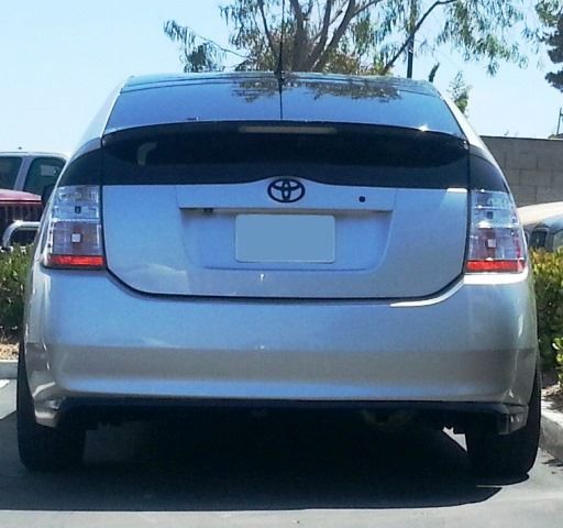

    Rear wiper delete - For a much sleeker look!
    - only recommended in climates (I'm in SoCal) where the rear wiper is rarely used or needed.
    After removing the wiper assembly - again with a 10mm socket - I used a painted gloss black 1" electrical junction box punch out - sealed with a waterproof silicone.

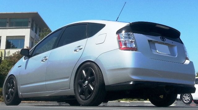

  2. Justdidit
    Justdidit LVNPZEV
    Jun 12, 2012
    1,880
    711
    75
    Carrollton, Texas
    Four Touring

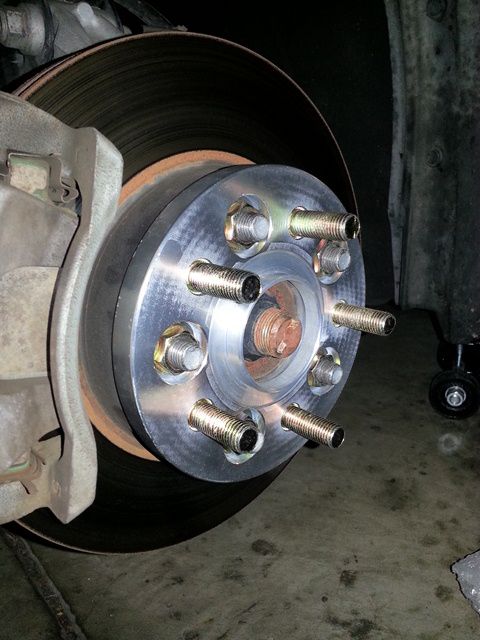

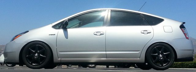

    Spacers
    Still on Stock Touring 16" - Fenders rolled, on GC sleeves - most mods in signature hyper linked:
    Simple Bolt on spacers (15mm)
    15mm spacer in front
    30mm spacer in rear
    Side
    Rear Angle
    Rear
  3. ss_neogeo
    ss_neogeo Junior Member
    Jul 19, 2010
    22
    Arizona
    For the longest time, I've always wanted clean shots of the Gen2 with spacers on the front and rear. Thank you very much!

  8. Justdidit
    Justdidit LVNPZEV
    Jun 12, 2012
    1,880
    711
    75
    Carrollton, Texas
    Four Touring
    Stock G2 Touring wheel is 16x6 has an 45 offset, 54.1 Center bore
    Stock G2 Standard wheel is 15x6 has an 45 offset, 54.1 Center bore
    Pretty sure what they sell are wheel ring adapters. These take the stock 54.1 to whatever size the aftermarket wheel has.. so ex: Oem 54.1 -> aftermarket wheel with 73.1 would need these rings: Hub Centric Rings 73 1 54 1 Toyota Celica Corona Matrix MR2 Prius Set of 4 | eBay
  9. Justdidit
    Justdidit LVNPZEV
    Jun 12, 2012
    1,880
    711
    75
    Carrollton, Texas
    Four Touring
    No rubbing on fenders - as I mentioned, 1. I have rolled fenders. 2. You have to remember I'm running Ground Control Sleeves with a custom spring rate in the rear - stiffer than most.
    But, because I'm so low, I go pretty slow over speed bumps. The only issue I have currently is my Tanabe Sustec Front Under brace TUB151F hitting on the speed bump if I go over it too fast. If I ease over them, no issues, if I go a little too fast, you can hear the impact of the bar on the bump - sounds awful.

  11. AquaJan
    AquaJan Junior Member
    Dec 27, 2011
    47
    17
    US
    Really like this look! (y)
    I assume you had to go inside to remove the motor to eliminate the threaded part ?
    How did that go?
  12. Justdidit
    Justdidit LVNPZEV
    Jun 12, 2012
    1,880
    711
    75
    Carrollton, Texas
    Four Touring
    The Wiper blade is held on by a 10mm nut that is hid by the plastic cap that most people have modified to free the wiper from not being able to pull the blade/arm away from the glass. With the cap removed you can undo the 10mm nut. However the wiper arm requires a bit of tugging (at least on mine) to get it to release from the motor shaft. After I removed the arm without breaking the glass, i started popping off all the interior paneling on the underside of the trunk lid. The wiper motor has a quick disconnect wiring that I zipped up after I unplugged it to keep it from rattling around. Then several 10mm nuts later that were very easy to loosen the motor came free of the trunk lid. The only relatively hard part was pulling the wiper arm off the motor shaft.
    See this post: What did you do to ur Prius today???? | Page 109 | PriusChat
    and even tho this is a Gen3...the directions are pretty much the same. Just haven't verified the 1 3/8" hole vs my 1" metal punch out holes... They are only like $1...
    Daves09prius likes this.
  13. AquaJan
    Dec 27, 2011
    47
    17
    US
    That's great Rodney! Very inspiring! You're right about the wiper arm being stubborn, I think a few drops of penetrating oil would have helped.
    As of now I have a little black rubber boot stuck on with some silicone covering the stud. It looks like a little antenna!
    I noticed in my owners manual that that interior cover needs to be removed to change the license plate lamp also. So now all I need is a 1" KO blank...
    Thanks again Rodney and Justdidit for posting :)

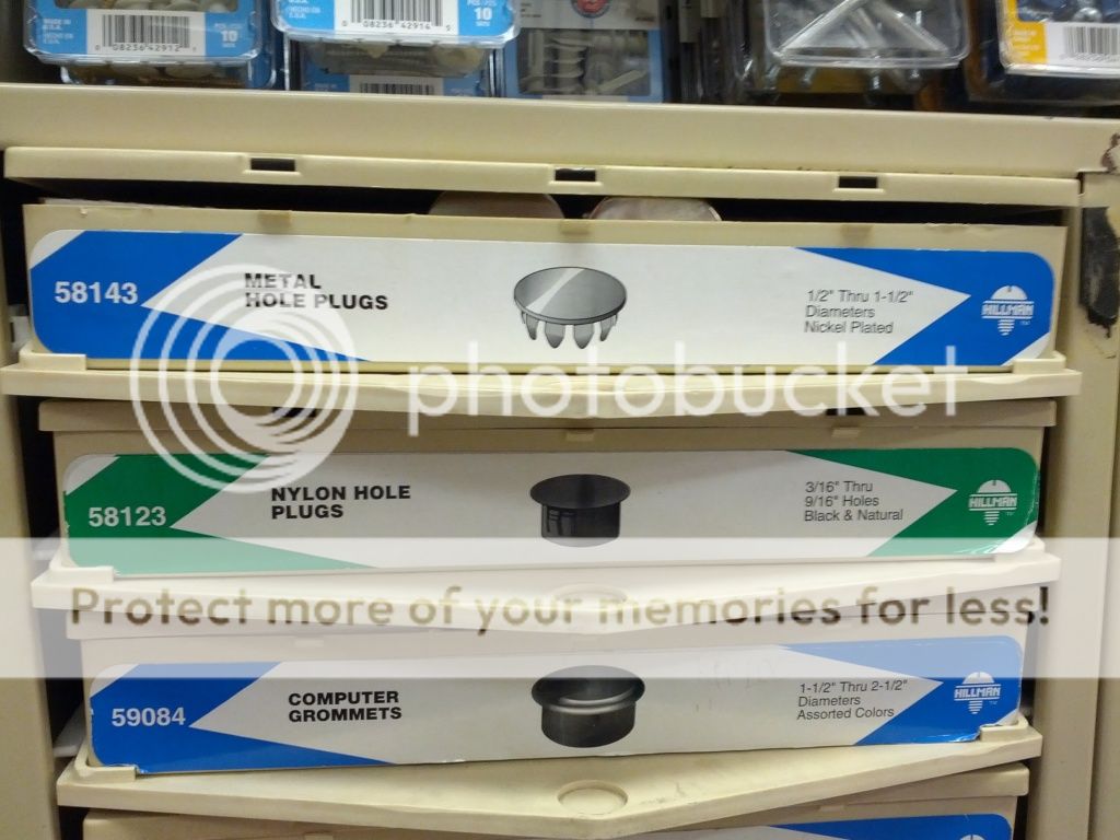

    You should be able to find the hole cover in the hardware aisle of either HomeDepot or Lowe's. I found mine in the drawers of all the specialty hardware items.
    Less than $2 for the Hillman brand at Lowes.
    -Jeremy
