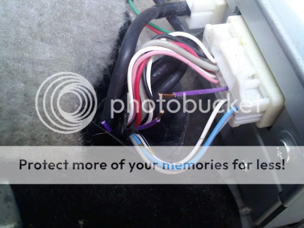

    Good to know that part works.. because the software get-a-round does not seem to work as there is no "overide" button I can find in the hidden menu.
    Anyway, I intend to install mine in a slightly different spot..
    I"ve already encountered a hitch... apparently the 06 wires are slightly different than the earlier models.
    If I understand right Aquarians2 has an 09 and he simply cut the purple wire so maybe thats it?
    This is a pic of the large wiring harness that comes off the back of the DVD player... I only see one purple wire instead of two.... what am I missing?

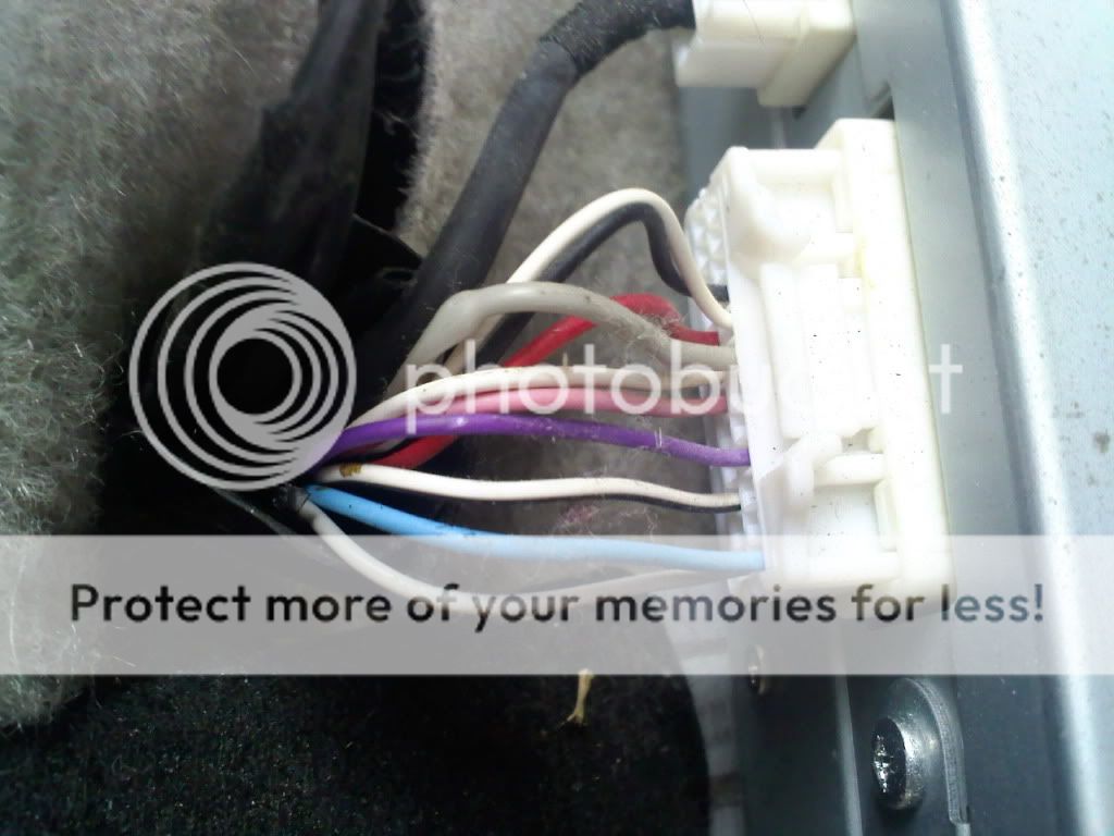

    The Purple wire did the trick on my 06!.. works perfectly!

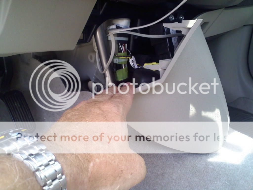

    First of all.. thanks to Evan for explaining it a bit as I didn't seem to quite understand by reading the forums. If all you want to do is get back your maps and menus, the purple wire near the DVD player does the trick. If you also want to be able to access phone numbers etc, then the smaller purple wire "found elsewhere as mentioned in previous instructions" must be switched.
    There is only "one" purple wire found near the DVD.. this is the wire we will be cutting.
    I will attempt to explain how I did mine.
    I installed my switch "radio shack" in a different spot altogether allowing me to totally bypass tearing into the center console at all.

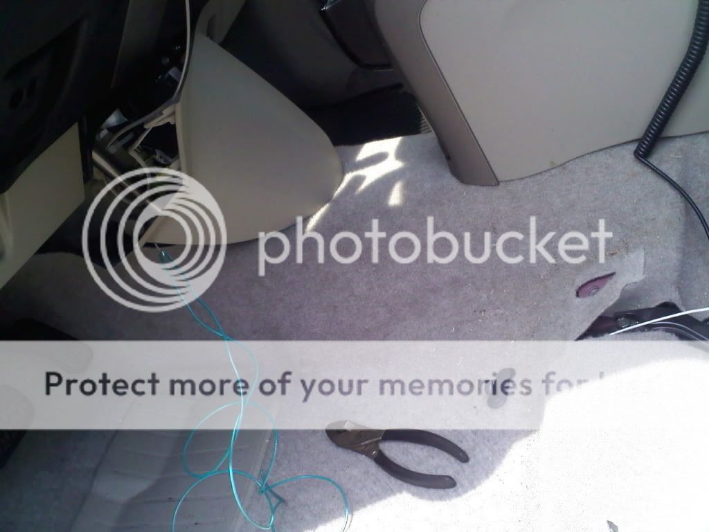

    1. I unscrewed the bolts to my seat.. there are 4.
    I used an electric drill with a socket, but anything will work... once undone, I lifted the seat and lay it back resting on the back seat while still in the floorboard. That got it out of my way for plenty of room.

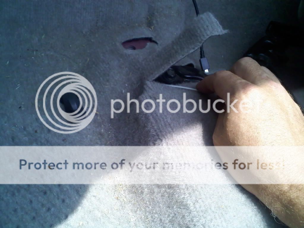

    2. I took a coat hanger and straightened it with a pair of pliers and accessed the hole in the carpet near the dvd "closest" to the console.
    There is insulation padding under the carpet, so make sure you take your fingers and lift the carpet and insulation to get the coat hanger wire underneath it all or it will get stuck.

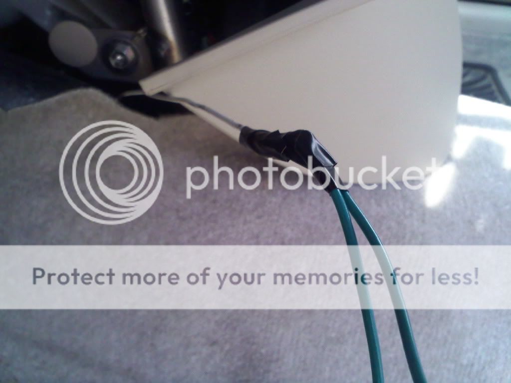

    3. Pop the top of the middle plastic panel loose as shown and undo the carpet from the button that holds it underneath and stick your hand down between the carpet and the floorboard to try and meet the coathanger wire so you can grab it and pull it up. Note, you only need half of the panel loose.. no need to take the whole panel off.
    4. With a little trial and error, you will fish the wire through and pull it through so you can hook your wire to the other end that will go to your switch.
    Cut off enough wire to travel from where the switch will be to the large plugin that goes into the DVD player... add about 1 foot for good measure, then double the whole length so you are pulling "two wires through, as you will need to go to the switch and then return.
    My wire was about 6 feet long, bent over in the middle and I hooked it to the coathanger wire which I bent over with a pair of pliers.
    5. Then covered it in electrical tape so jagged ends would not catch when I pulled it through.
    6. Once pulled through, you may want to fish it one more time so it also travels under the 8 inches or so of carpet to put the wires directly in the same spot the other OEM wires are.

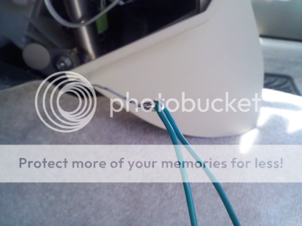

    7. Once you get your wires pulled through to where you can access them its time to cut your purple wire.

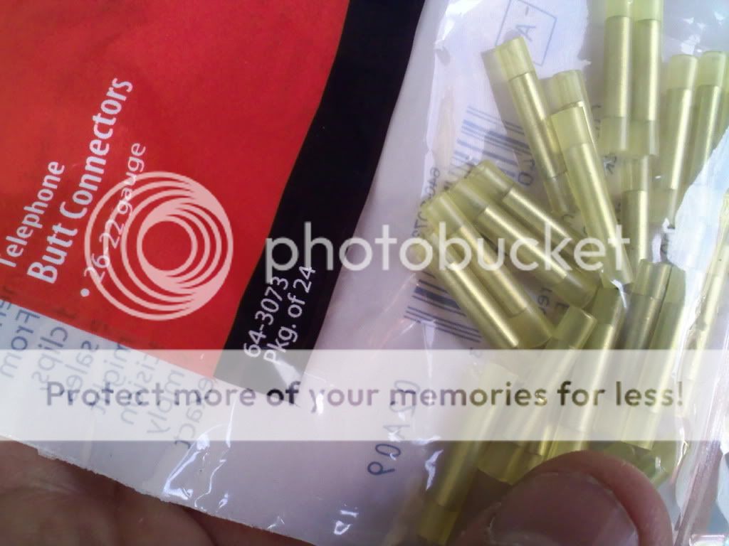

    8. Here are some crimp connectors radio shack sells but I decided to soldier and use heat shrink instead... "be care with heat around those little wires when you shrink the tubing!" Especially if you use a propane torch like I did!.. had to turn it down very low!
    The purple wire is not solid. I put soldering flux and soldiered all my tips and then connected with the hot iron.. but to each his own.
    9. Whether you use crimp connectors or soldier, once your done here, you can remount your seat if you like "or do it later".

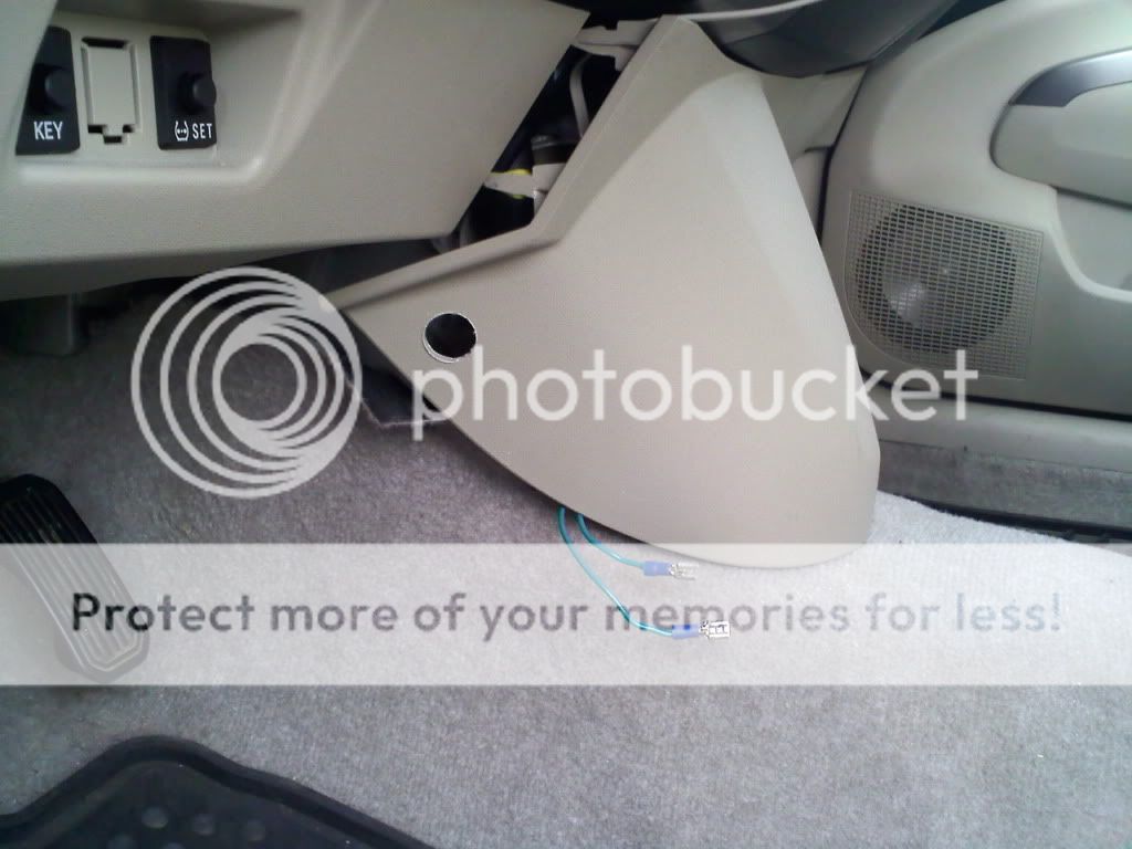

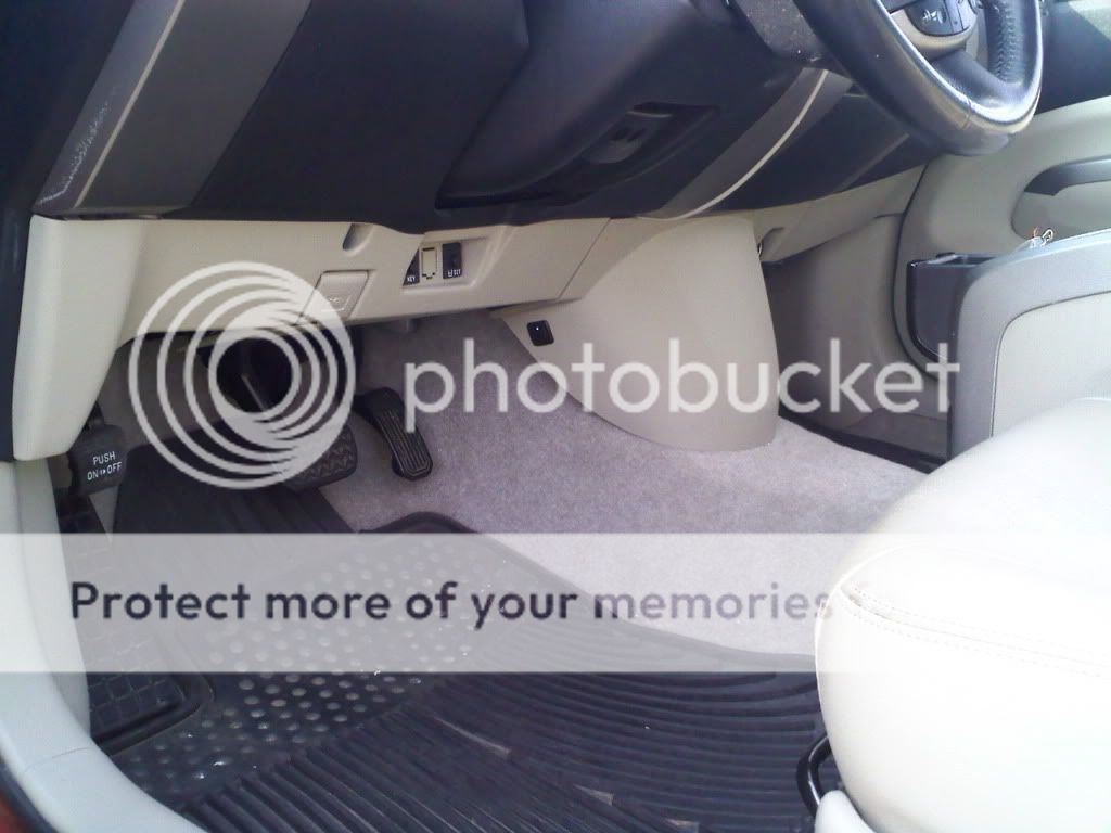

    10. Now its time to mount the switch. I used the radio shack switch "with a dot" to designate being on or connected... chose which you like. Mine required a 3/4 inch hole to be drilled. I used a wood auger with a flat blade.... "worked perfect".. be careful when almost done as you don't let the bit go through and chew up your fingers or other wires behind the panel!
    11. I took a couple of connectors to hook my wire to the switch rather than soldier at this point.. If I ever need to take that panel lose further, it would be a pain if I couldn't easily disconnect the switch.
    Here you can see the wires dangeling and the hole cut right before the switch is mounted.
    12. Once the switch is mounted, pop the cover back on and your done!
