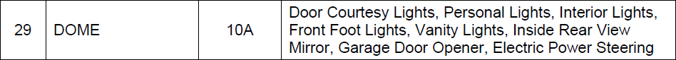

    The traction control light had me puzzled until I checked:
    As mentioned above, I'm going with a short, which can be a b*tch to locate. Good Luck.

    OP, that's allot of items to check thru. I find it odd that Toyota put the interior lights on the same circuit as the electric power steering. Is the car drivable with this blown fuse?
