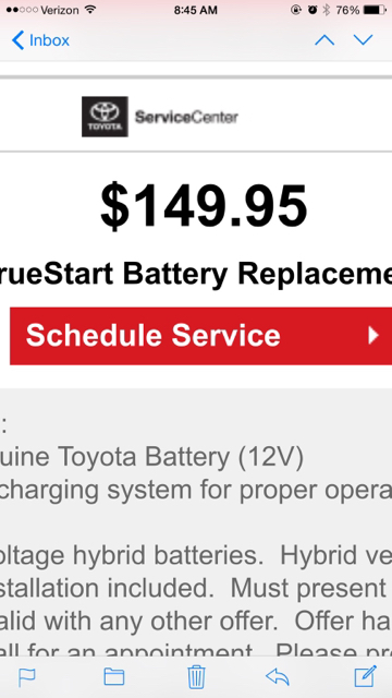

    I don't know where you are located or if all Toyota dealers (or regional) are the same price, but I was given an advertisement that says to come to the dealer and get my battery replaced with a Trustart battery for $149 installed.
    I am in California.
