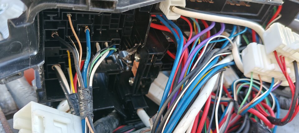

    So gang. Just trying to change the dreaded 125A fuse. Split the fuse box open but still can't access the darn fuse. Any ideas. Including pic

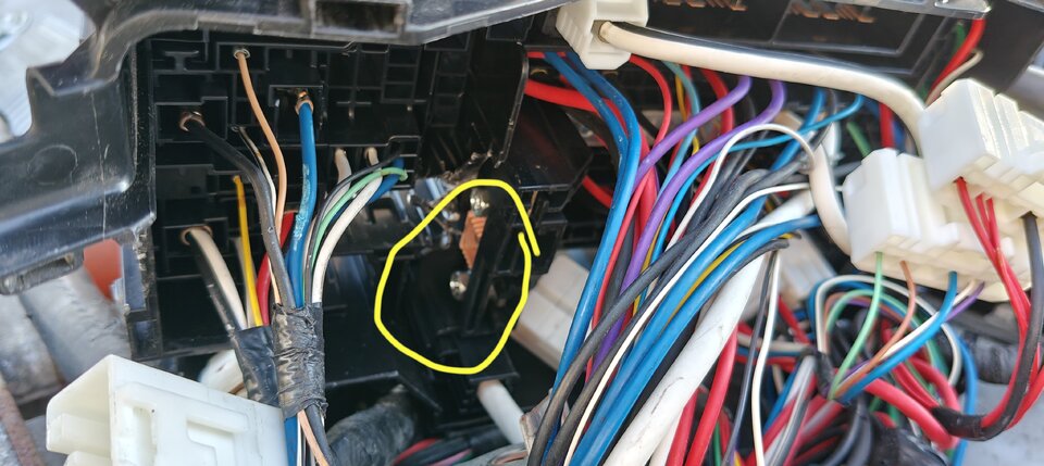

    Oh the pic is from the bottom of the split fuse box. Let me circle the fuse

    Got the fuse out with much difficulty. Turns out it is fine. Back to drawing board.
