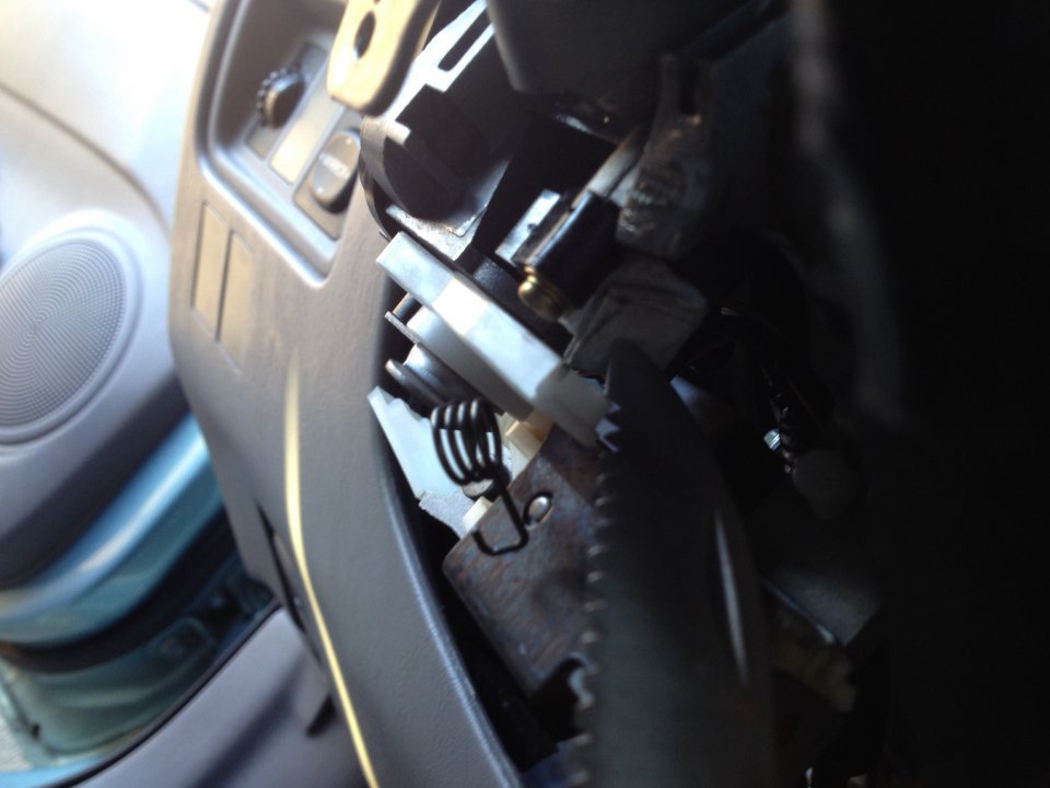

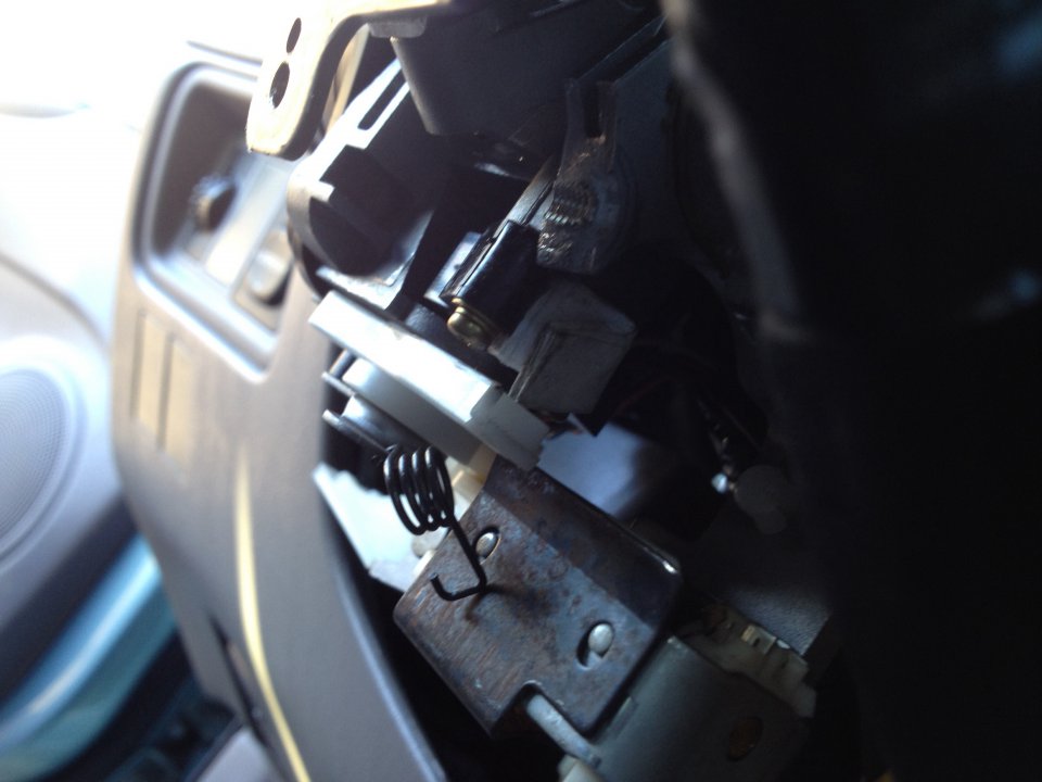

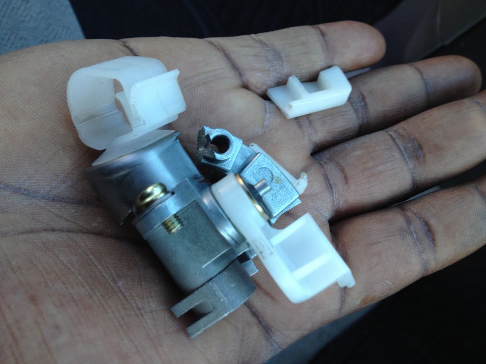

  10. Dman90
    Dman90 Junior Member
    Oct 5, 2014
    Tracy, California
    2001 Prius
    I
    Here are pics of the problem. I ended up glueing a paper down to the button so it stays pressed. The broken piece is useless and can get in the way of the shifter causing the car to be in between gears and sometimes it can be hard to press the button to shift the stick
    LEVE likes this.
  11. Dman90
    Oct 5, 2014
    Tracy, California
    2001 Prius
    I
    It's pretty easy to avoid taking the key out while driving. As long as the car can shift into gears and release the key without disconnecting battery it's fine. Saves the hassle of opening trunk and removing terminal and dealing with possible p3191 errors when the fuel level is under 3 gallons and car misreads it as an empty tank
  12. Dman90
    Oct 5, 2014
    Tracy, California
    2001 Prius
    I
    Hope my pics help. It can be a cheap fix or a costly one. It probably also depends on how the piece breaks off so it can be more complicated if your piece didn't make a clean break like mine did, but only way to find out is removing that cover to see.
