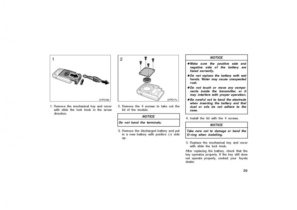

    If you have Smart Key and the remote battery dies, it won't unlock the car, but if you put the key in the key slot it will still start the car. Didn't see if you checked the Smart Key button below steering wheel and if that fixed the problem.
    Here is how to change the remote battery on the 2007 Prius.
    Replacing the Wireless Remote Battery-CR2032
    I've included the page from the Owner's Manual, but my steps are numbered slightly differently.
    1. Remove the mechanical valet metal key from the side of key remote;
    2. Remove the emblem cover while sliding the lock knob on the end in the arrow direction.
    3. Remove the 4 screws to take out the metal lid off the module.
    4. Remove the discharged battery and put in a new battery with positive (+) side up.
    5.Install the lid with the 4 screws.
    6.Replace the emblem cover and the mechanical key while sliding the lock knob.
    After replacing the battery, check that the key operates properly. If the key still does not operate properly, the comment about the 12-volt is next suspect. It can cause a myriad of quirks.

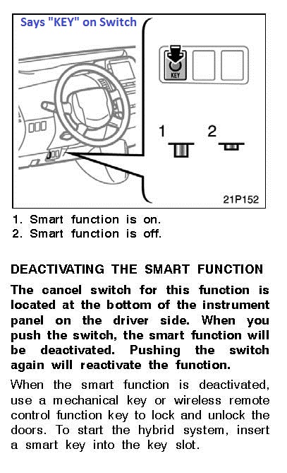

    The button is below the steering wheel column, and says "KEY" on the label.

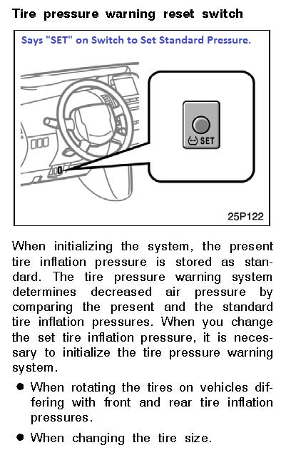

    Here are Drawings of two switches you may have under your Steering Wheel, the Smart Key Activation Switch and the Tire Pressure Warning Reset Switch.
