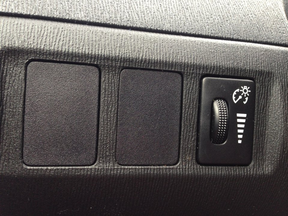

    I've seen mentioned that it can be turned off by accidentally pressing a button on the side left of the dash, but I don't have that button. Just a blank square where that button is supposed to be, so it can't be that.

    I really don't have it. That's where it should be, right?
  4. Starcheckered
    Starcheckered Junior Member
    Aug 10, 2011
    Baltimore
    I really don't think I have it. See below.

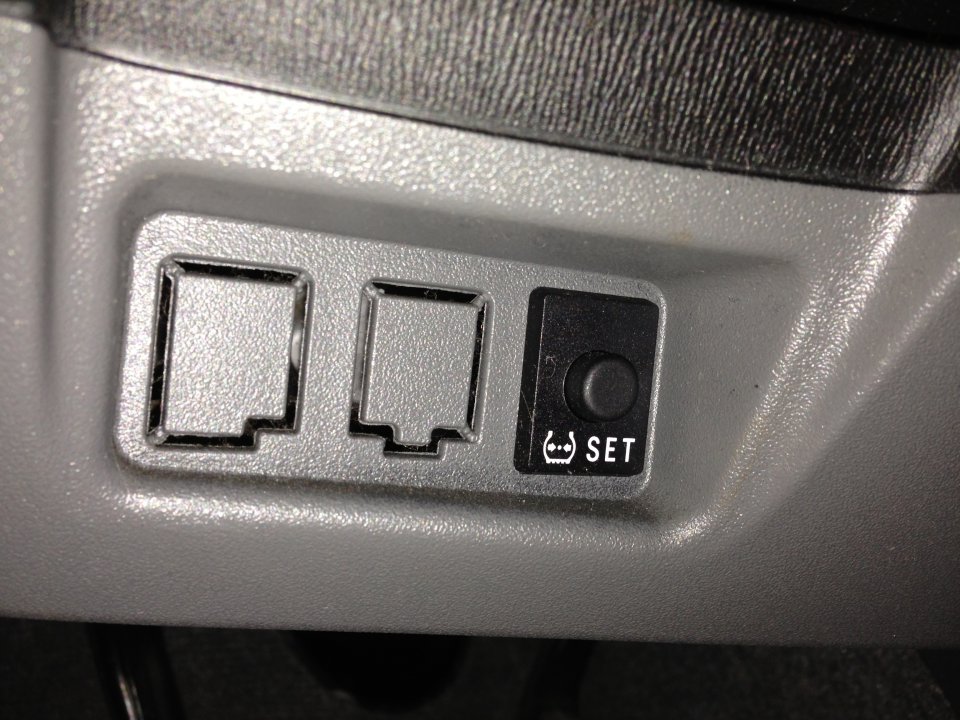

    No. Under the steering wheel. Above the brake pedal.

    My car has never turned on if the fob isn't inside the ignition. Is there a way to make that work?
    This is what's under the steering wheel. I really don't think I have this button hahaha
  7. BFAyer
    BFAyer Junior Member
    Nov 3, 2007
    Gloucester, VA.
    Well then I can't help, because all 2008s with smart key have the button.
