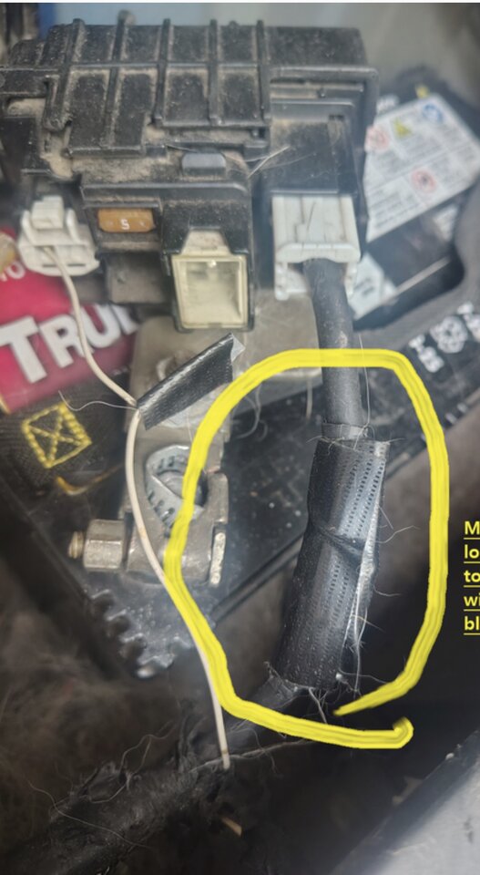

    The other end of that heavy cable is connected as the supply source for the underhood fuse box in the upper driverside of the engine compartment. There is no real slack to be had.
    You'll either need to get the crimp fitting removed, opened up and recrimped/soldered, OR do what some others have done and find a salvage yard that has a gen 2, cut that cable several inches back and crimp/splice the new piece of 'yard' cable onto yours. You don't want to make a loop in the wire, so you'll need to trim it as needed to get the correct original length. Otherwise it's just a pain to stuff it in place.

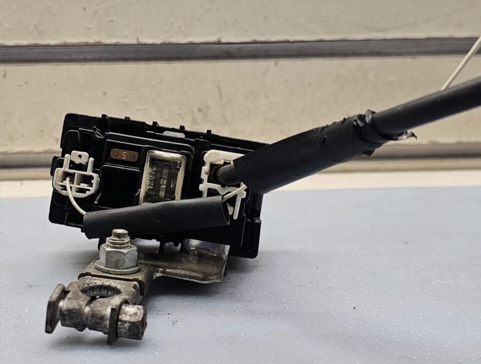

    update:
    half accomplished. got about 6" off that cable which is firmly into the connector off a salvage car. much more length is hard to get as this cable becomes intertwined with others (the main?) that make pulling out more length to cut unfeasible. there is very little slack available at all at most 2-3 inches anyways. the cable basically makes a straight shot to the positive terminal with no room for modifications in length.
    think I'm gonna go with my idea of jamming the wires together. once you cut the cable you see there are about a dozen heavy duty steel wiress housed within the cable. i'm gonna need a breakaway to prevent this from happening again. ideally toyota should have had a white connector about a foot back that I could detach (however i guess ideally i should be living in a warmer place. always forget about this snow/ice in the middle of summer).

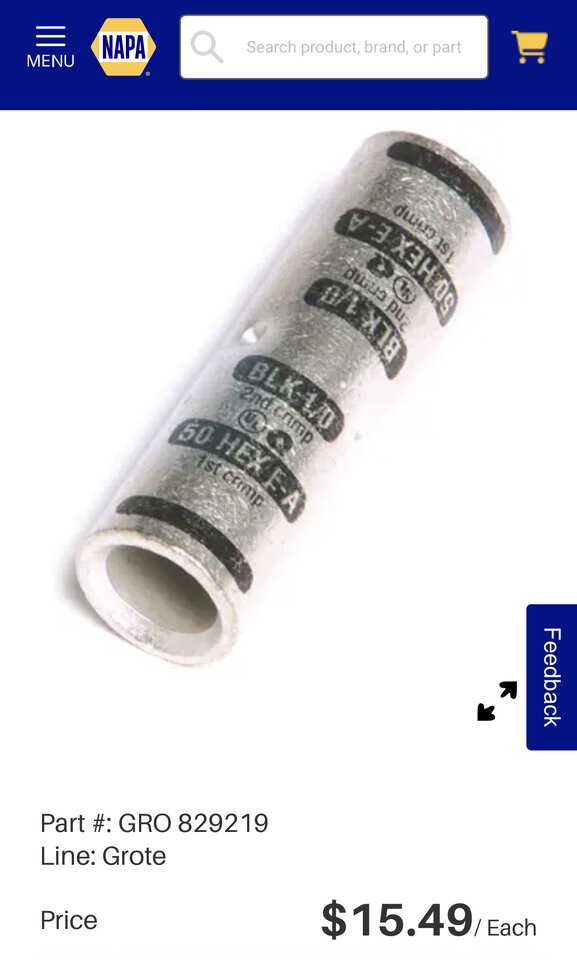

    The markings on that splice identify the not one but two distinct special tools and dies to be used to properly crimp it onto the wire.
    Your neighborhood independent auto electric shoppe already has the right tools and dies to do that, and when they're done you'll have a properly all-around-crimped and insulated connection, more reliable than the set-screw butt connectors, and they'll probably be done in a couple minutes and you'll be on your way for a nominal charge.

    WILL THE ABOVE PICTURED CRIMPS BE ADEQUATE TO = a solder or hydraulic crimp re: transfer of voltage and codes P0A080 being dismissed?
    some are saying to replace entire cable (not feasible because its connected to the harness and stupid expensive). Just want to know how much something like this might cost to repair professionally as well. My local NAPA suggested I do it myself but kinda worried about not doing it correctly.

    maybe I'm not being clear in my question, basically the the NAPA part GRO #829219 seems to be the correct method and more secure method vs. hand-tool crimps above (home depot and others). However, the NAPA crimp would require going to the shop as i don't have the tools.
    The wires are crimped together very lightly and also with about 4 extra inches of slack in the black-cable to allow for a proper repair.
    IF it can be adequately repaired (no voltage issues, no codes) with the hand-tool options then although I don't prefer that method, at least I don't have to wait for a shop. Many shops turned me down (maybe too easy or too difficult to do correctly, not sure). but i'll have to wait a while do to everyone else having car issues because of the snowfall cold.

    You can get a auto shop to crimp the appropriate Napa crimp sleeve later.

    Your pic

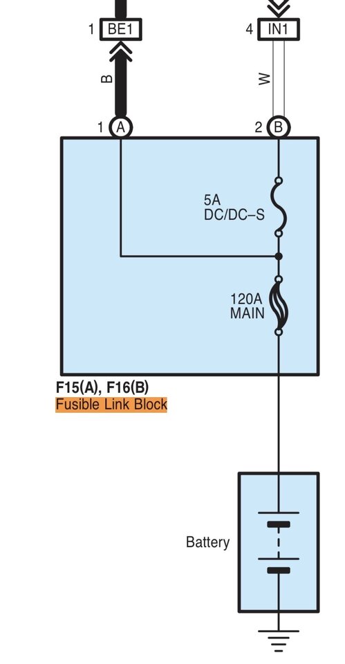

    The thick black multi strand conductor on the right is the main 12v cable. The multiple strands ("wires") inside are built that way to make the cable flexible rather than one huge diameter conductor. All of those strands go into the splice device.
    Factory Setup
    The thin white wire is separate and is for remote monitoring of the battery voltage. It is not included in the splice. You already have it separated and taped together in the first pic above.
    Schematic for Tech Reference
    #34 rjparker, Feb 5, 2026

    After seeing your photo, which includes the (+) battery post, you need more help than just a splice. Quit jerry rigging and get it fixed correctly so you don't have to worry about breaking down. You're worried about a "correctly done splice" but have no worries about the (+) post? That terminal post clamp is available for about 15 bucks new. These are the things that drive me crazy when customers complain about something not working...........Crazy...............

    Yeah, I hadn't even noticed the hose-clamp ornament there. :)
    That clamp is probably too loose because somebody once overtightened the clamp bolt and bent the legs together.
    The clamp is a tinned copper stamping (not cast lead as many are), and can probably have the legs bent back out in a couple minutes by somebody good with a couple pairs of pliers.

    Yeah, I've been meaning to replace positive-terminal because its messed up. Luckily, my car always starts so I don't think about it much but next time I'm at the salvage yard I'm gonna try to replace all needed items.
