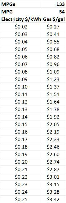

    What do you mean by "fees and so forth?" If you mean you are including taxes and other fees that go up and down depending on how much electricity you use, yes you should add those on to your calculations. IMO you shouldn't add one time/base fees that don't change regardless of how much electricity you use. In other words, I'm still going to pay those fees whether I have a plug in or not, so why would I add them to my plug in cost?

    In short, yes, I agree. But for more detail, here in Austin, they break it down, perhaps semi-pointlessly, into the “Energy Charge” (the actual electricity itself), a “Power-supply adjustment,” (not really sure what that is), “Regulatory Charge,” and then several assorted lesser charges. The electricity itself is only 2.8c/KWh, but the total per KWh works out to 10-12c/KWh.

    Gotcha, ya that makes it tough to figure out then. Here we have a base charges and fees, then our energy + tax.

    i just divide the total bill by kWh used. doesn't really matter what the rest of the bill looks like, or if the electrons are free.

    It’s easy to mistakenly see the 2.8c/KWh number and think that’s it.
