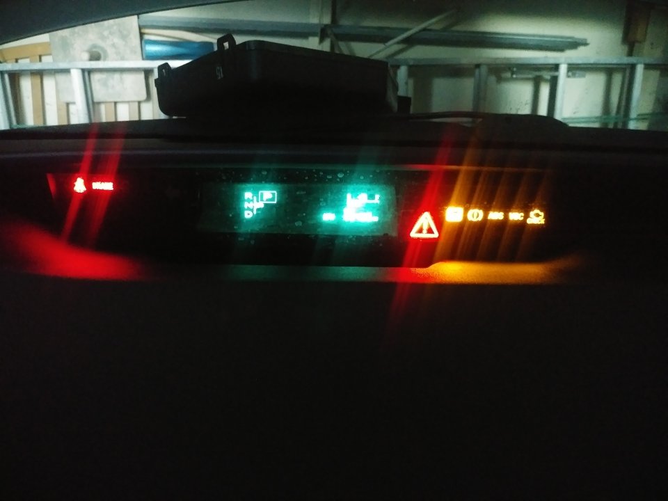

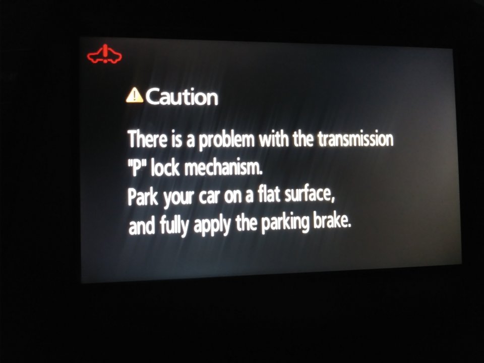

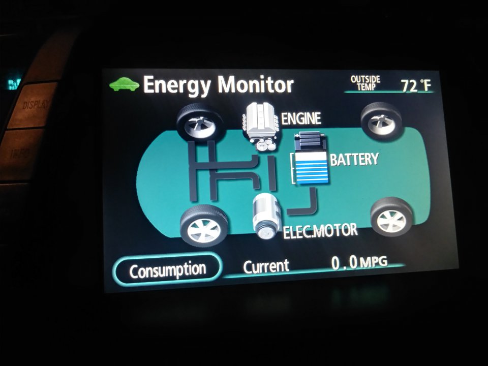

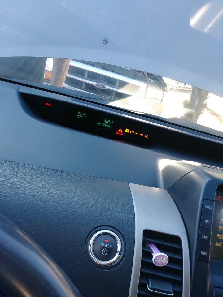

    Hello, about a week or two ago my Prius would not start at all so I had to jump start it and then everything seemed to be fine. Yesterday morning when I was ready to drive to work it just wouldn't fully turn on "READY" mode. These two times I noticed all of the dash lights go on and off then the car would completely die and the dash lights got dim and my car just froze. Now my car is not turning on at all unless I jump start it.
    Any ideas of what might be happening?
    Thank you in advance :)

    The Prius has several batteries.
    Your Fob has a small battery ($3?) and dies about every 3 years.
    Almost all the car uses a 12 volt battery that like all lead acid batteries lasts about 4 years. In the Gen 2 and Gen 3 Prius it is in the passenger compartment with the humans, so needs to be externally vented and use AGM electrolyte. It will have smaller JIS posts than 'normal' car batteries. As such it is expensive as car batteries go. ($150 - $200) This is the battery that has failed in Susana's Prius. While it is a easy DIY task, it is also available at the Toyota dealership with a 84 month warranty.
    amazon.com/ACDelco-ACDB24R-Advantage-Automotive-Battery/dp/B010GKJ8F6
    Finally, the high voltage battery is the pricey one, but it lasts over 10 years on average. Thankfully it is not @Susana 's issue.

    She needs a new 12 Volt battery for sure!

    Summary: Her 12 V battery has gone bad.
    A replacement at a dealership will cost around $200.
    From other sources, maybe $150.

    agreed, new 12 volt battery, clear the error codes should be good to go. if you go to a place like like auto zone or advanced auto they will install for free
