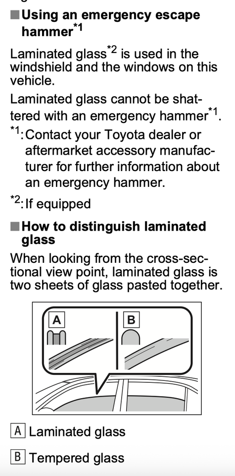

    Waiting on an '26 DL, so I can't look at the glass cross section.
    It doesn't look too good for escaping if the side windows are laminated.
    Of course the windshield is laminated, but how about the hatch?
    The manual has the ever-popular "if equipped" footnote.

    Thanks. In any event, it would probably be good to verify on the actual car.
  4. VelvetFoot
    VelvetFoot Senior Member
    Sep 17, 2025
    1,408
    545
    New York State
    2026 Prius
    I hadn't known this. The car manual turned me on to this, so it is indeed good for something!

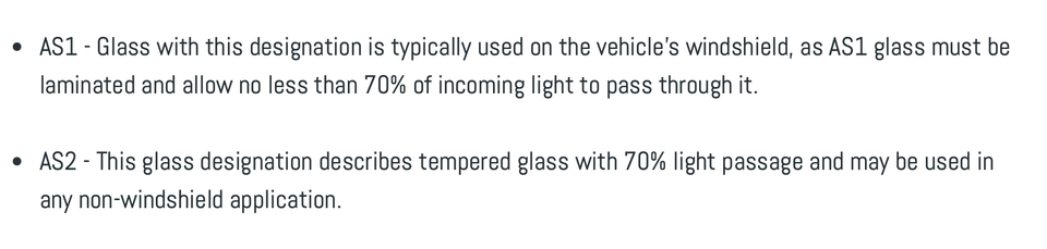

    I just went to the garage and looked at my MINI glass.
    The front and rear side windows don't appear to be laminated by looking at the cross section.
    The markings of AS2, see below, would also indicate tempered, and not laminated.
    The rear hatch is also marked AS2.
    I could find no markings on the panoramic sunroof. They could be there, I just couldn't find them

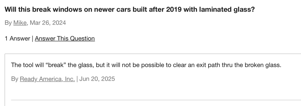

    Or this.
    Thing is, if a driver or passenger is trying to get out, there are positional limitations and possibly physical limitations imposed by the accident.
    Also, reading a response from Ready America on that product:
