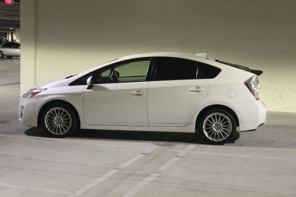

    I'm looking to get larger tires for the set of rims I have currently on my Prius. I was wondering what effects that would have?
    P.S. I want to make the ride smoother.

    It looks like you have a 17" rims now. Your tires are probably 50 profile? Regular Prius rims are 15" and those are used with 65 profile tires. The latter rims+tires would ride much softer than what you have now. Using higher profile tires on your existing rim would make the ride softer, but rubber might start rubbing the wheel wells in turns, and speedometer/ odometer will be a little off.
    Running tires at 32 psi ( or whatever the recommended pressure is) also will make softer ride

    Well I was thinking about increasing the tire wall, making it taller, not wider

    They are 17" rims with 45 profile tires I believe.

    I'm game to play 20 questions:

    yes they are.

    Thanks. I think F8L's suggestion of 205/50R17 (post #7) is spot-on. It makes the outside diameter virtually identical to 195/65R15 (OEM 15" tire), just very slightly bigger. I'm considering that myself, just a little concern about the XL rating.
