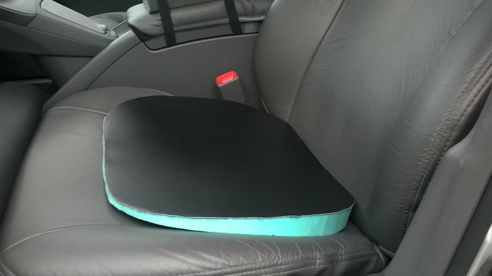

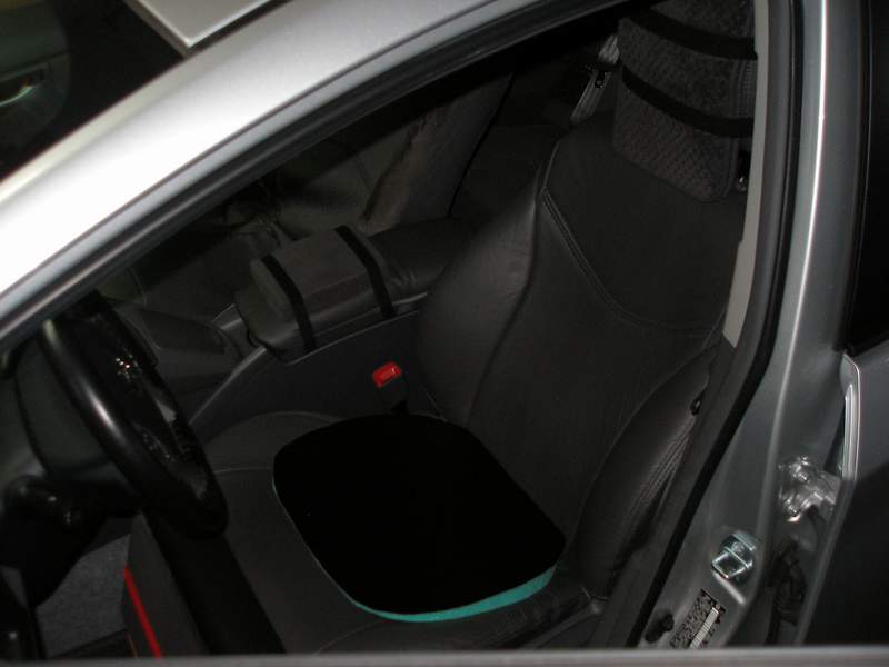

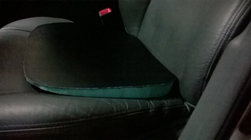

    WP_20150118_14_39_33_Pro.jpg A custom cut cushion: 1 1/4" at back end tapering to 1/4" at front. Covered by vinyl, spray-glued on. Just finished this morning, it should correct the excess cushion tilt ( seat only 2 pumps up out of 30 possible).

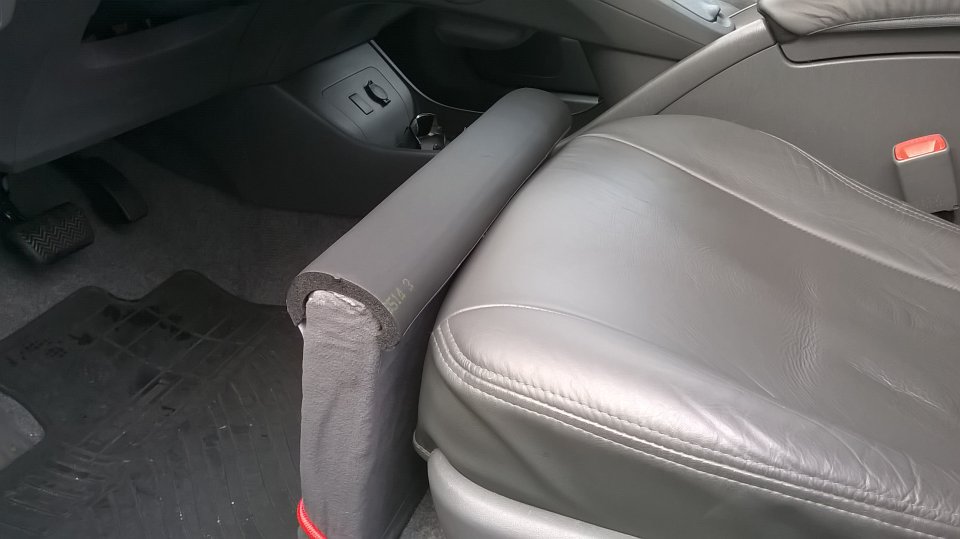

    WP_20141218_09_27_48_Pro.jpg Custom built legrest box. I've since covered the pipe insulation foam with Black vinyl.

    I couldn't find what I needed online or in stores so I made it / had it made -

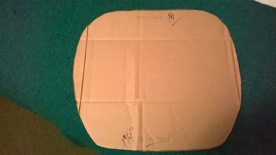

    WP_20150122_08_02_03_Pro.jpg I'll bet you could benefit from a small lumbar cushion and thin wedge cushion. I'll bet you may not need a lumbar cushion any thicker than 1/2" or maybe 3/4". Another Prius chatter used Bob's foam here for a small lumbar cushion.
    you might be able to keep it in place using 3M Command stripes, maybe not.
    Here 's template I made for wedge cushion. I traced it from a Winplus gel cushion that didn't work out -
    All the wedge and lumbar cushions I've seen are large and thick, but we tall folks don't have much head or seat room to spare.
    I Google search foam factories and I see listings. Hopefully you're near a metro area.
